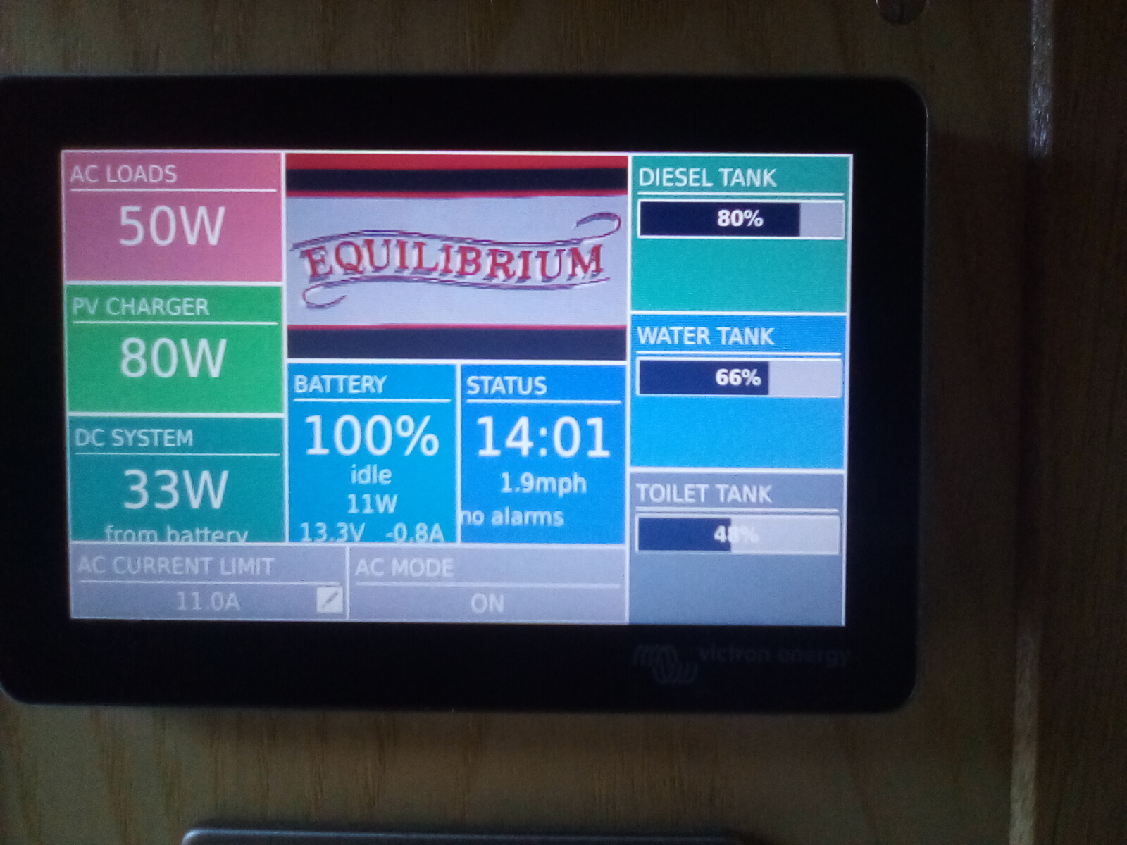

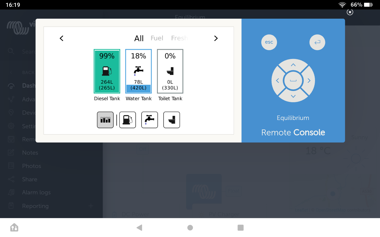

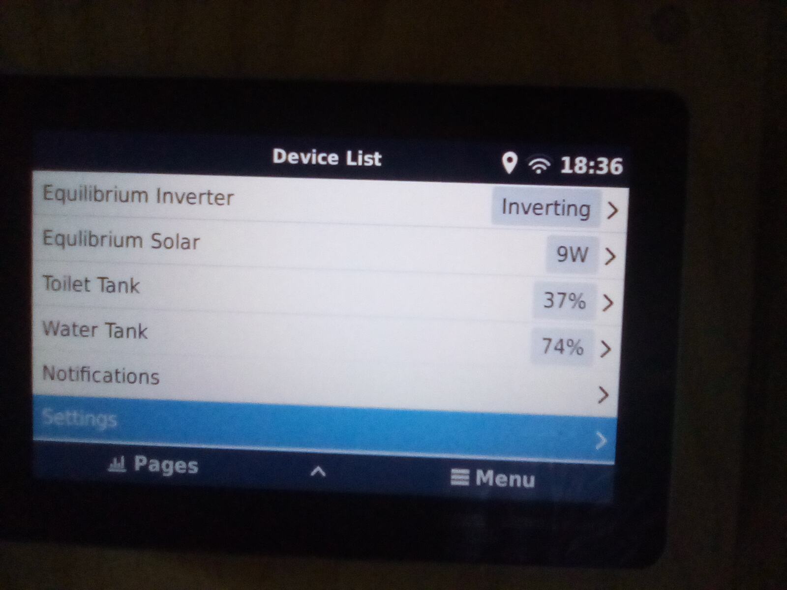

We've got a problem with the tank senders not showing up on the Cerbo Touch Screen

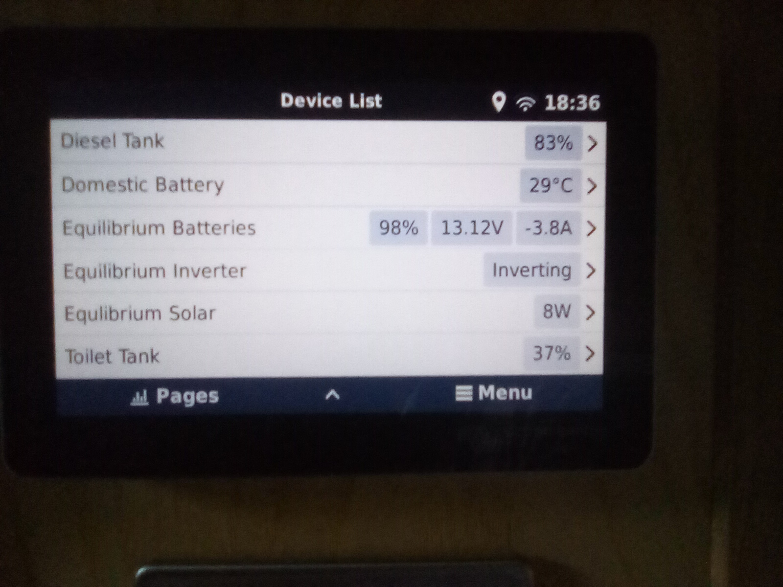

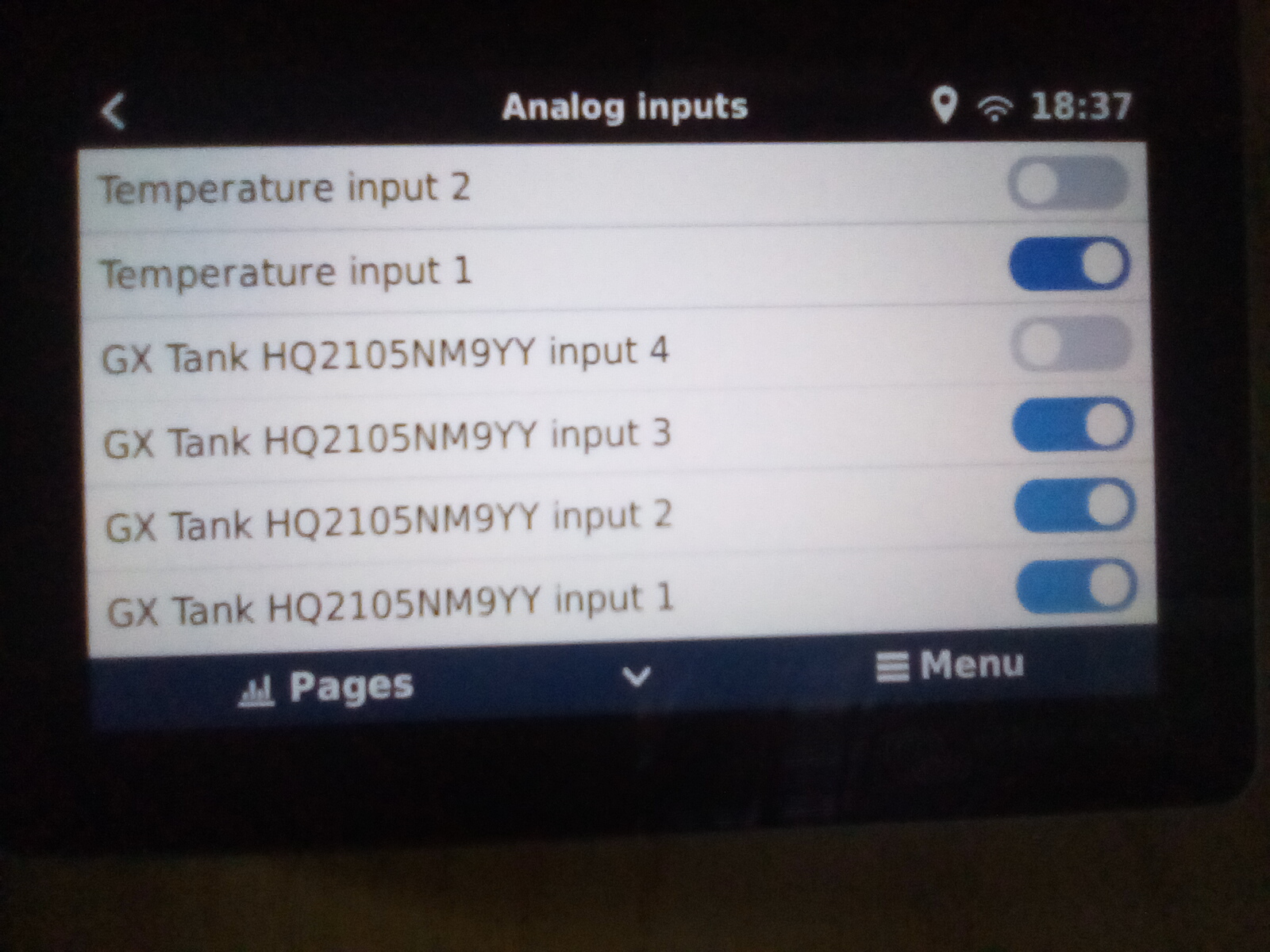

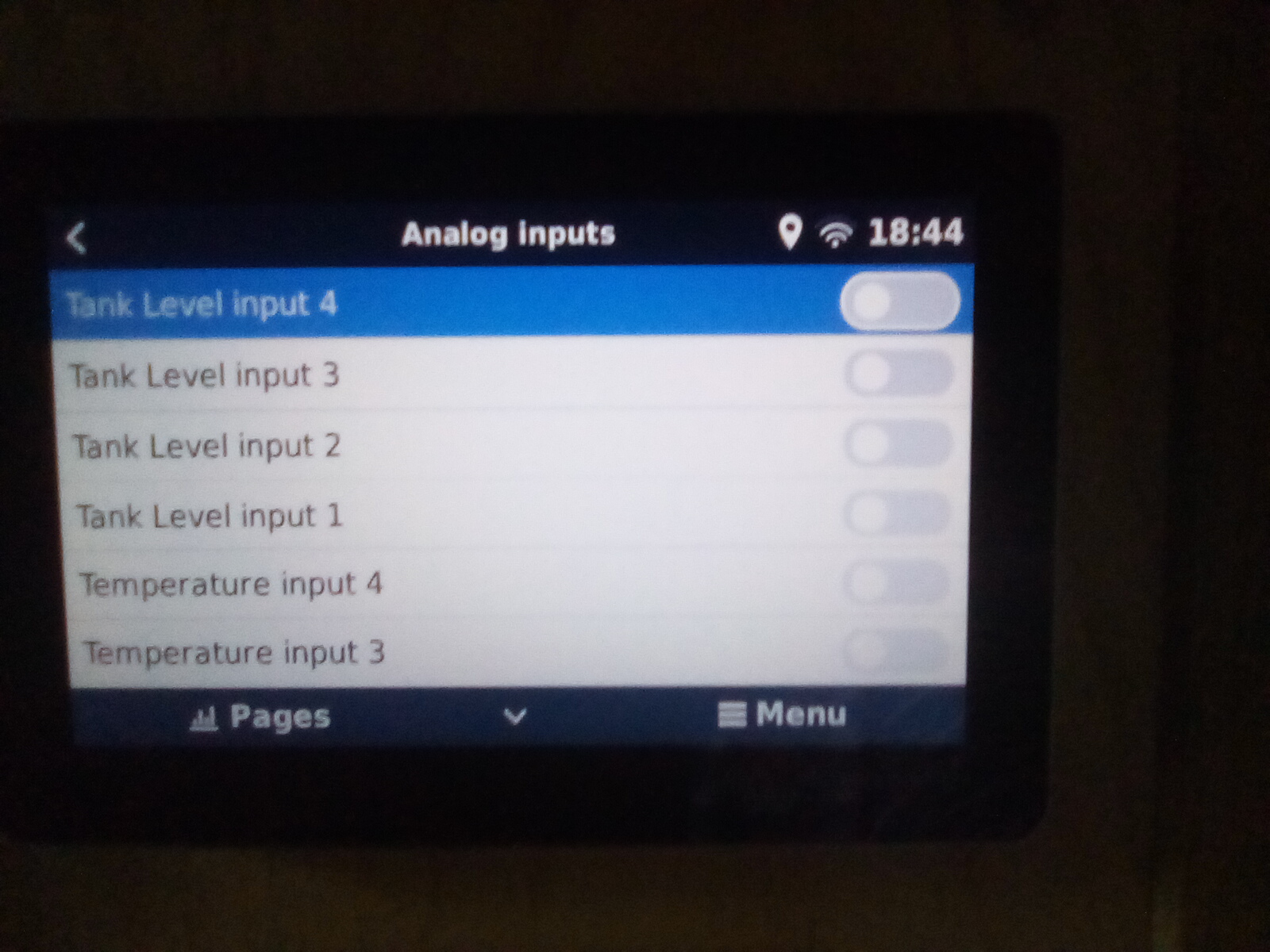

We use voltage tank senders by supplied MSC Boat Products. We have checked the voltage to and from the senders and all is good. However on the Cerbo Touch Screen we are not getting the option in the 'Setup' menu that shows 'Sensor Type' Voltage as per the instruction manual - we've had to set it as Custom as no Voltage option is shown. On the device list it is also showing as disconnected but clicking on the device sub menu it is showing as connected.
