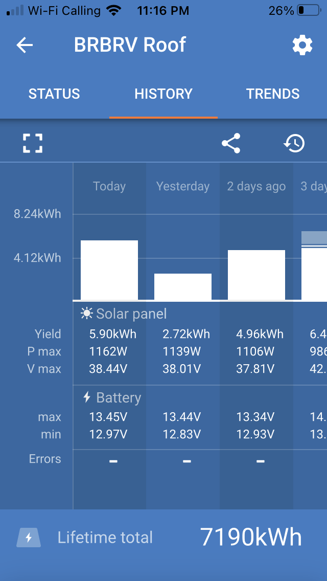

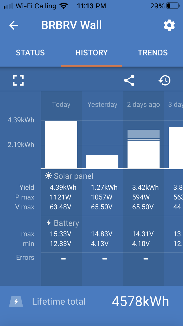

I have two solar arrays running on two different Victron controllers. I replaced a defective PV in my 6-panel solar wall array. The old panel was 190w and the new one is 200w. Upon enabling the wall controller, I noticed higher solar voltage and lower amperage readings. I anticipated this because of the wattage increase for the replacement panel. What I didn’t expect are incorrect low and high battery readings when viewing the history. Do I need to recalibrate my BMV?
The BRBRV Wall screenshot displays the incorrect data while the BRBRV Roof (8-panel array) readings are correct. Any advice appreciated.
