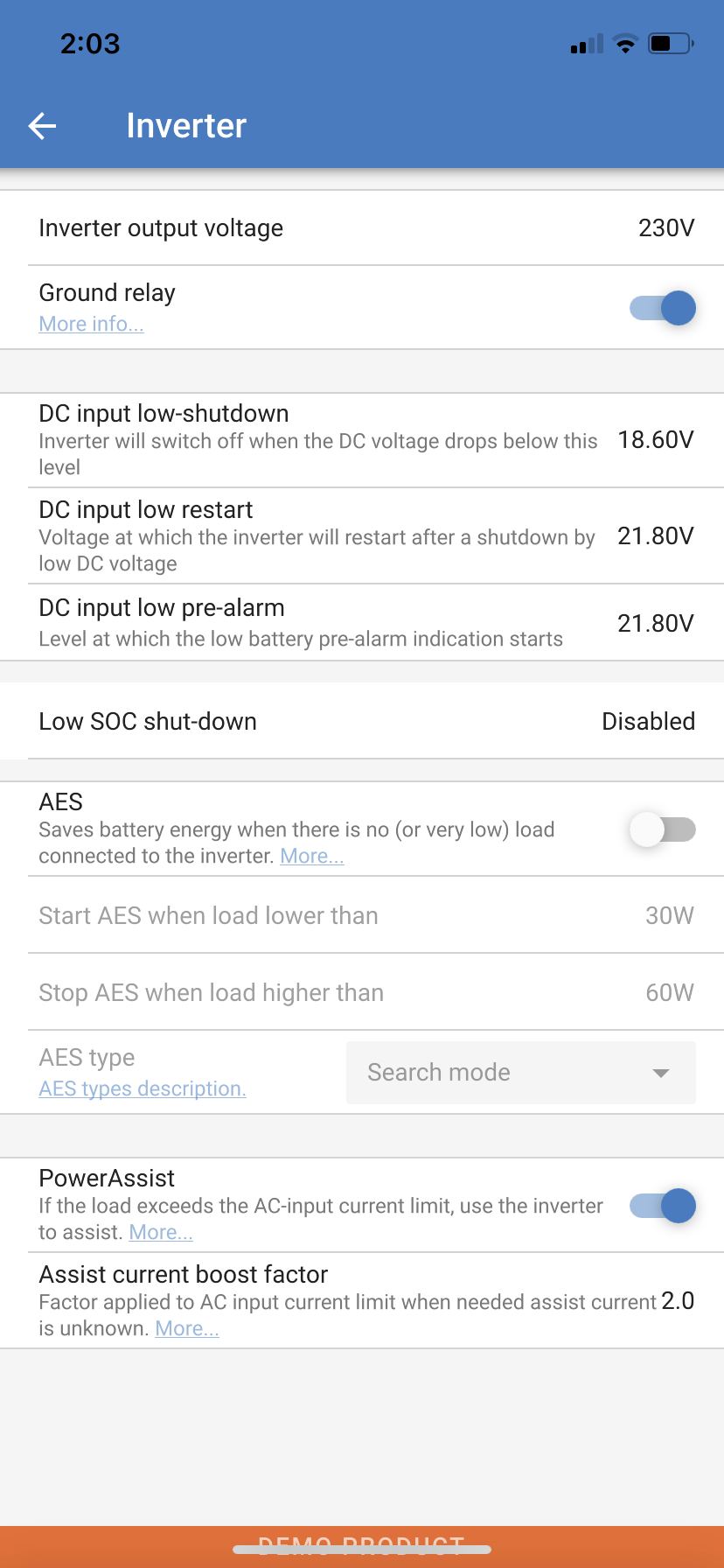

I was wondering if there is a way to limit how much power the powerassist feature adds to the shore power coming in? I've seen that there is a setting that allows you to limit at what shore power input the powerassist kicks on but not how much power will be added.
I have the 24/3000/70 and have not setup my solar system on my rv yet so haven't been able to look for the setting itself.
The reason why I need to know is that I have to run triplex wire 30 feet from shore power to multiplus and 30 feet from multiplus to my ac distribution panel. If I can limit the powerassist+shorepower to never go above 30A then I can run 10awg triplex for both wire runs. If not I have to get 6awg triplex to run from multiplus to ac distribution and it is considerably more expensive wire.
