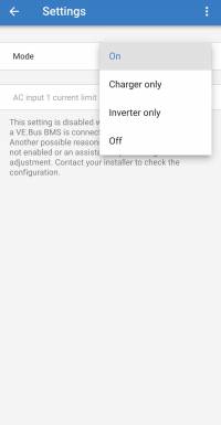

Edit. I use the ve bus smart dongle switch it off over bluetooth.
It has the on off charger option.
