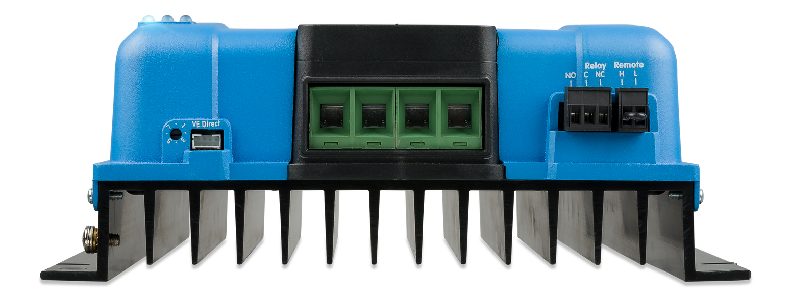

But some of the larger mppts have a remote on off port for this reason. Or you can get can connected mppts.
https://www.victronenergy.com/upload/cache/1561552643_upload_documents_1550_1000-SmartSolar%20MPPT%20150-70-Tr%20%28connections%29.png
