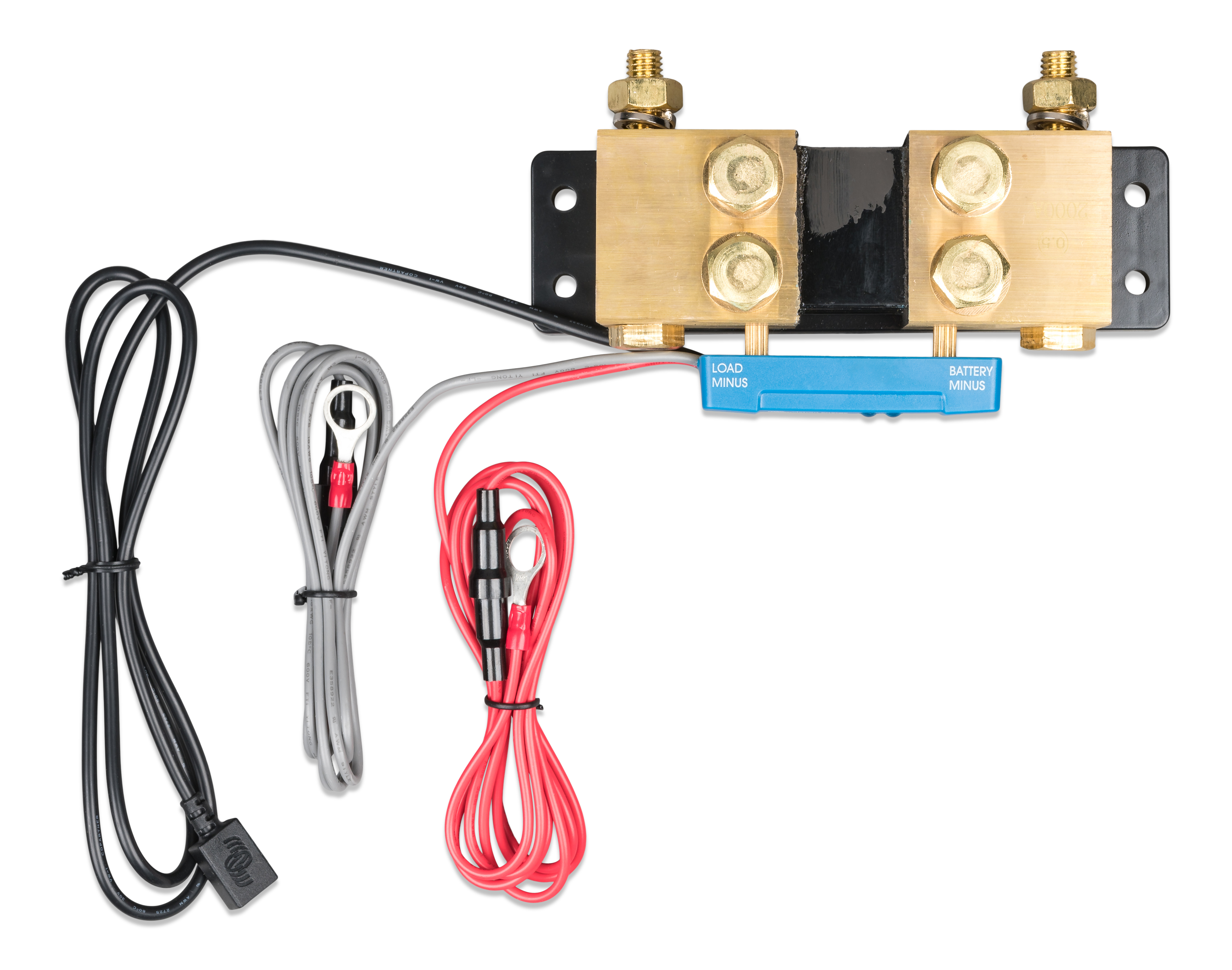

Have a look at the shunt, https://www.victronenergy.com/download-photo/5149 , ALL loads and charging sources have to be connected to the "load" side of the shunt. You then have 1 nice thick cable between the "batt" side of the shunt and the battery negative, the battery only has that cable and volt/temp sense wires.
https://www.victronenergy.com/upload/documents/Quickinstallsheet_BMV70x_part1_2.pdf
