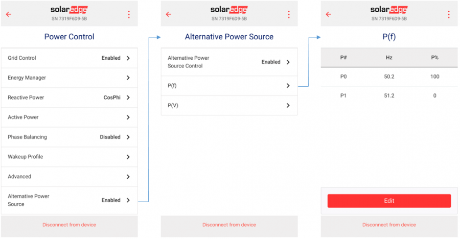

we recently have installed Solaregde with Victron.
Switching to APS-Mode during Grid Failure works well, this we have tested already.
But we have not tested frequency shifting so far.

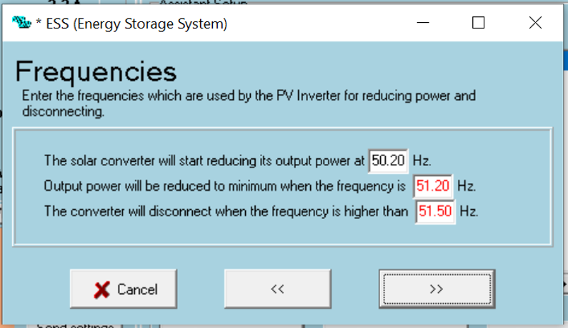

Have you set up frequency shift in SE Power Control APS-settings??
exactly like this?
and also in Multisplus ESS assistent?
We will test it maybe within the next days.
But i have to admit, i think the values for frequency shift are very tight!
I am a bit worried, if this really works flawlessly?!
50,2 to 51,2Hz is a very small window for regulation...
On Fronius, Frequency shift goes up to 53Hz, which lets way more room for smooth regulation
0 Likes 0 ·

I have indeed and tested the relay changing state from country grid to DG. The only reason I tested the response was that the Victron document states you need to call SolarEdge to enable it on the back end. Solar Edge came back saying it wasn't required and I'd set it up correctly. A healthy dose of scepticism saved my kit on this occasion. I tested at 100% first but that was a stupid thing to do. I've since discovered you can test at any battery voltage by setting the DVCC - charge voltage limit to a Volt less than what you are seeing currently. The Quattro will then drive the frequency up to try and stop production. It continues driving to the top set value as the solar edge doesn't respond.

what do you mean with "it has equivalent settings" ?
by default, no SE inverter has the required settings. I sure this is the same on your HD-Wave inverter.
by default, most SE models have this APS-Mode settings:
P0 = 50,2Hz - 100%
P1 = 51,2Hz - 100%
but you need to manually! change the P1 setting to:
P1 = 51,2Hz - 0%
can you confirm, that you have done this?!
I am not sure about this, reading throw your comments?!
