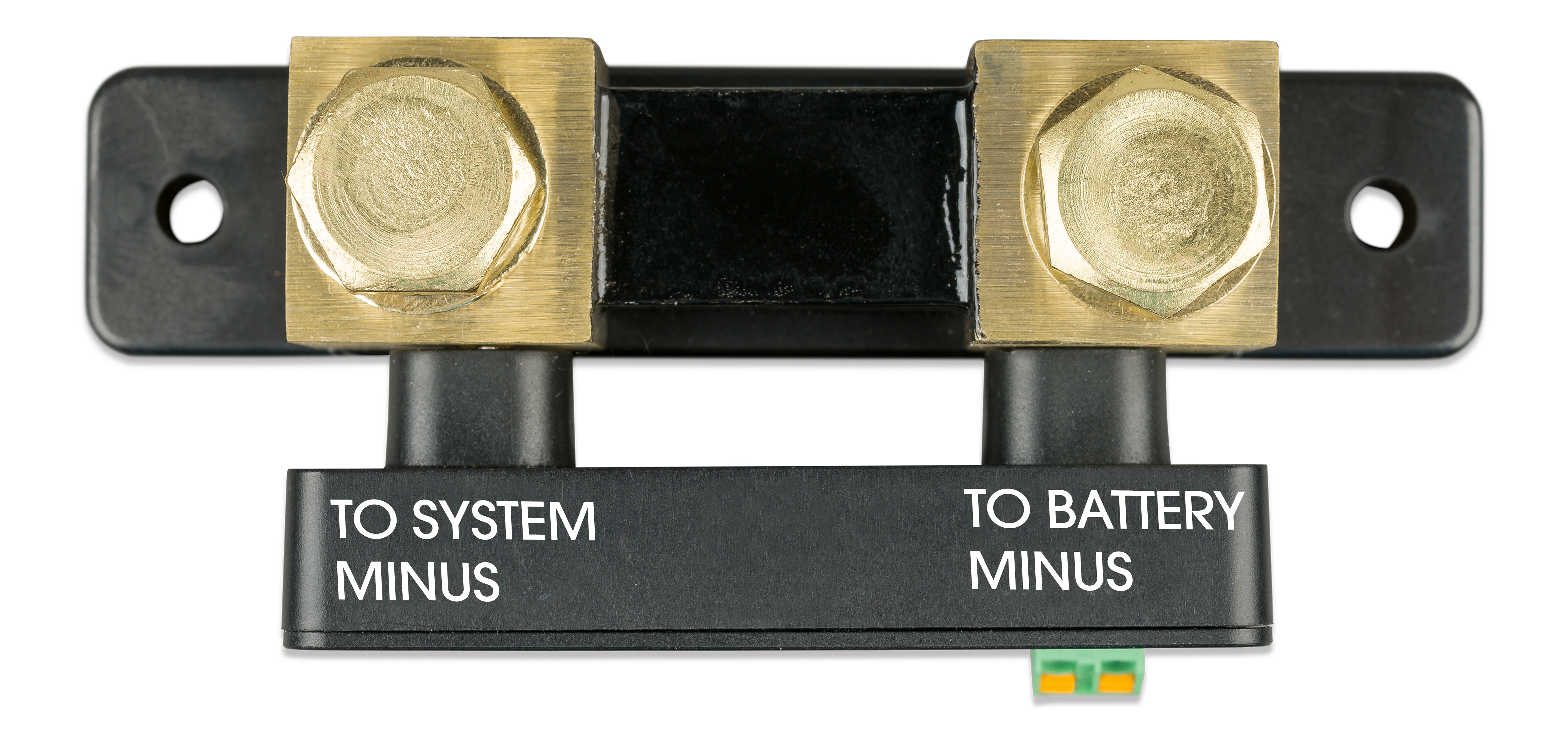

Normally errors in SOC are nailed down to 3 things.
Incorrect shunt wiring > loads and chargers must not bypass the shunt, the battery side of the shunt goes directly to the battery.
Badly programmed BMV's that wont synchronize reliably. Youtube tutorial.
Undersized arrays or excessive loads on the system.
