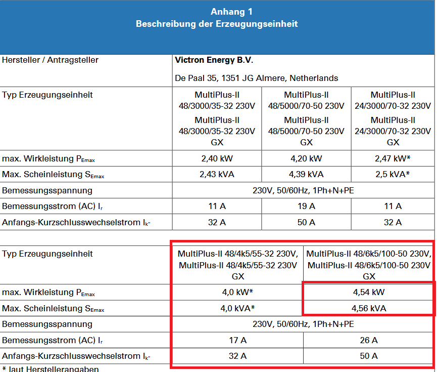

However, I have now found the certificate Certificate-VDE-AR-N-4105-2018-11-EZE-MultiPlus-II-(GX)-24V-3k,-48V-3k-4k5-5k-6k5.pdf, which shows 4.56 kVA. I have also seen a few posts indicating that the 5000’s 70 A charging current is not fully utilized and decreases over time.
As I am a beginner, I would like feedback on whether the 6k5 can alternatively be used single-phase in Germany, and by how much the charging current could be higher in the presumably AC-limited operation (~4.6 kVA input).

I don’t want a three-phase system; I simply want to get the maximum out of one inverter. The maximum apparent power of 4.56 is below the unbalanced-load limit of 4.6 kVA and should therefore be fine, if I understand the figures correctly.
That would make the 6k5 Victron’s new top model for single-phase installations.

One more point for my understanding. Because of the 4.6 kVA limit, the 6k5 can only feed a maximum of 4,600 W into the grid on a single phase, right? The 6,000 W output would only be possible in off-grid mode?
I haven’t been able to test or observe it yet, but I also think the 6k5 won’t be able to maintain its charging power continuously and will reduce it after a while.
You probably won’t reach 100 A either with the German grid code and the associated power limitation.
But I haven’t been able to test that either, and I won’t have any time left to do so this year.
In grid-connected operation, the power ratings specified in the certificate should apply; only in island mode can the power stated in the standard datasheet be assumed.

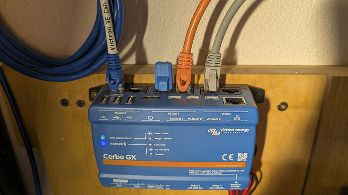

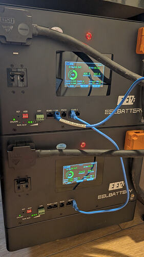

After four months, the DIY boxes were finally delivered last Friday and the system was assembled. MP2 6k5, Cerbo GX + 2x DIY Battery Boxes with JK19 BMS and 16x MB31 and VM-3P75CT each, connected single-phase.
Basically, charging and discharging work. DVCC is enabled. What I still find strange is that neither BMS, or the master BMS, is displayed in the Cerbo.
Everything is connected in this way.
Grey to the MultiPlus. Orange to the Smart Meter, blue to the DIY boxes.

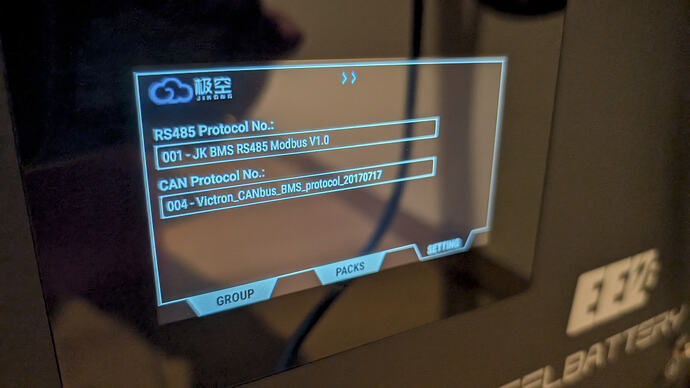

The protocols are set to:
I have the Type A cable. I read that it should work, but that Type B is recommended?
The VE.Can connection is set to 250 kbit/s in the Cerbo GX.

Have you tried 500 kbit/s? Most batteries use that.
Yes, I’ve just found it. I wasn’t quite sure yet which connection was CAN 1 and which was CAN 2… at first I thought they were the two connectors next to each other. I’ve just checked my own photo and seen that the BMS is connected to CAN 2. I’ve now set that to 500. Thanks, Matthias.
So, a summary for everyone reading this:
Remote Console: under Services / Ve.Can Port 1, Smart Meter and Cerbo are shown under Devices at 250 kbit/s, and Ve.Can Port 2 is now set to CAN-bus BMS LV at 500 kbit/s

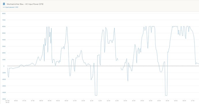

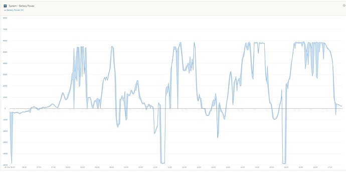

To return to my original question at the beginning of the post: what charging power can the 6k5 provide on a single phase? I now have some initial findings on this too. Throughout the day, the sky cleared up from time to time. In the VRM Portal, the displayed charging current then rose to as much as 109 A at a battery and inverter temperature of around 12–14°C. Peak output was around 5,880 W at approximately 53.5 V. I can’t yet say how long the system maintains this current, due to the constantly changing weather conditions.

You’re using the MP-II-6k5 purely as a charger, and at 5.88 kW you’re well above the 4.2 kW threshold above which, as far as I know, you have to register a controllable load with the network operator. This isn’t bureaucracy for its own sake; it’s intended to ensure grid stability.
Hello Tom,
I was wondering about this too. As I understand it, setting the GridCode should in principle limit the MultiPlus to 4.6 kVA. Is that not the case?
Best regards,
Martin
The 4.6 kW relates to a different issue, namely the inverter output. It must never create a greater load imbalance between two phases than these 4.6 kW. That would always be prohibited! In your case, however, this is about drawing power from the grid to charge the battery, and there is no limit for that—only a notification requirement, so that the grid operator knows what loads to expect on its network. So you can certainly draw 5.88 kW for charging, but the device must be installed and registered by an electrician, and it must be remotely controllable.
When operating on a single phase and configured for the German grid code, your MP-II should have a maximum inverter output of 4.6 kW. The question that remains open is whether this limit is lifted when operating on three phases.
Hello Tom,
so this is about the power output from the MultiPlus, which is then limited (inverter power). Just for your information, although I have no idea whether this changes anything regarding your point: I don’t import power from the grid to charge the battery. The power comes from the non-hybrid inverter and its 24.5 kWp system. Nevertheless, I presumably still have to comply with the phase imbalance limit, don’t I? Or does this not apply in this type of connection?
Best regards,
Martin
According to the datasheet, it can actually only supply 100 A of charging current to the battery…
Just for information. The two negative peaks are about a 10 kW load in the house.
