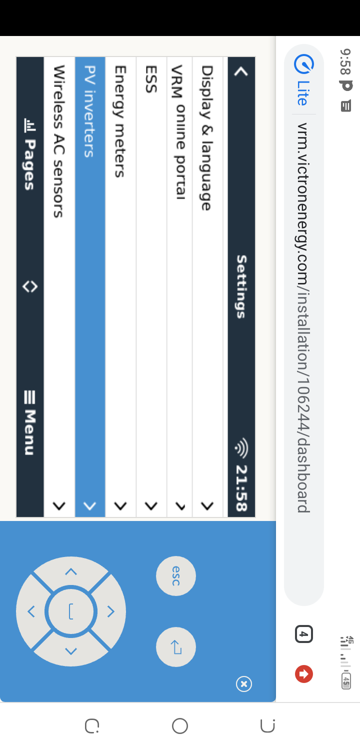

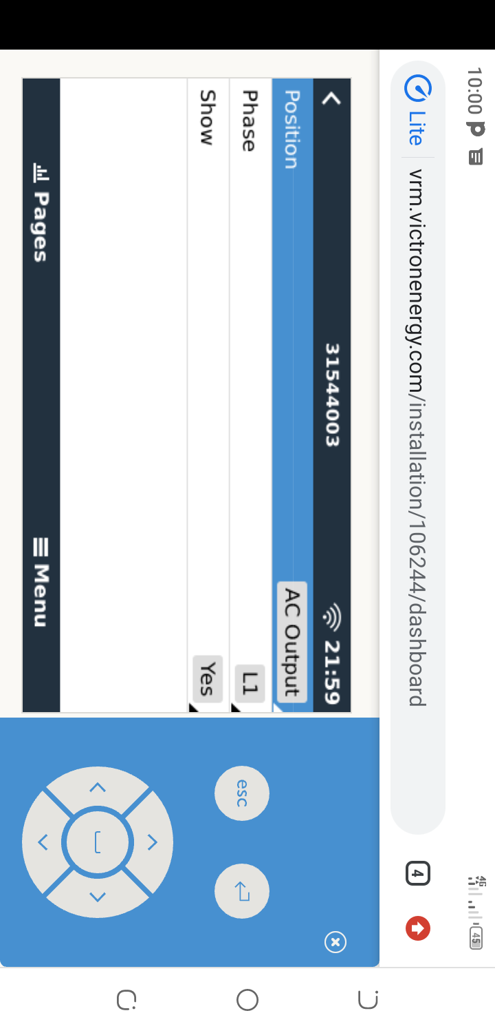

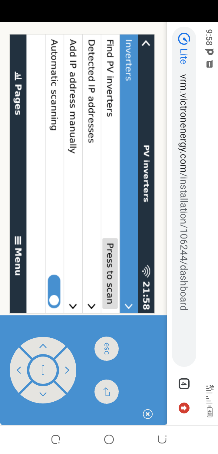

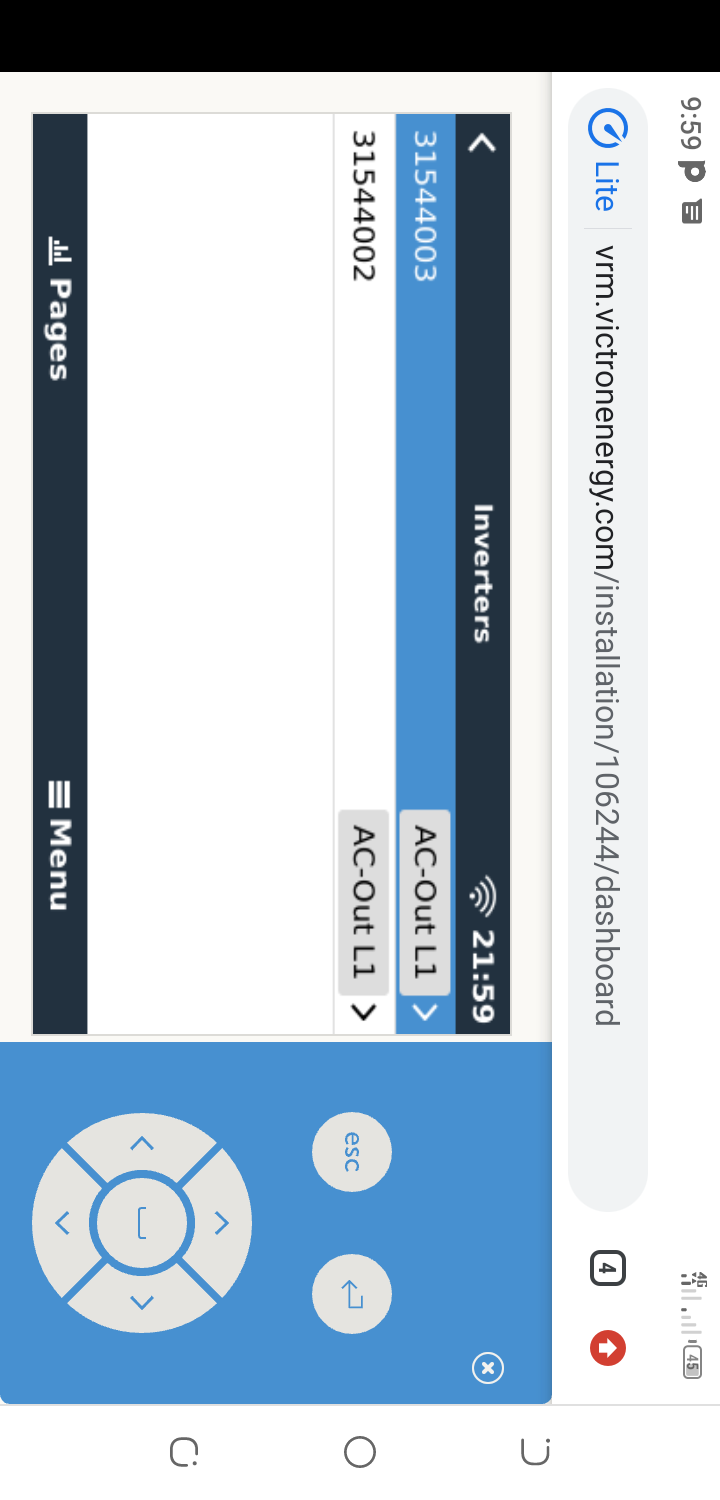

My CCGX Color has stopped showing the solar input on the home screen although the daily history is updating ok. The orange box is there and I can see the batteries are being charged from their voltage. The firmware is 2.11, I have rebooted several times but no change. It is connected to a Quattro 10000 by VE Bus and a Victron MPPT 150-35 by VE Direct. Any assistance would be greatly appreciated.
B Rgds Tim
