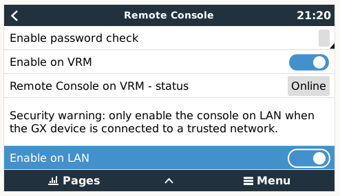

Do you have the option for "Enanble on LAN" switched on?

Thanks for the diggestion.
Yes, and I did the reboot after it. And when I try, I make sure the phone is on the same Wlan as the ccgx.
Guessing it might be password, but no prompt comes up.

I managed to get it working by enabling, then disabling the password.
Odd.
