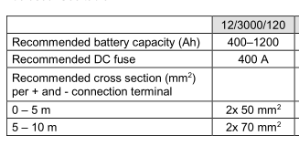

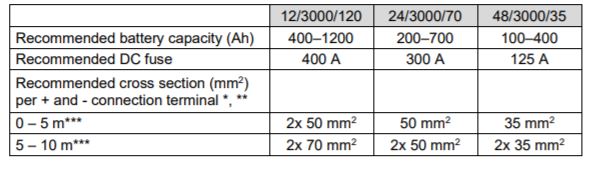

"To low. The wire from batterys to inverter are .50 ." The recommended dc wiring for your inverter is 2 x 50mm sq. (<5m)

Victron recommends 2x 50mm cables for your inverter, so your only at half the recommended.
Also all links between batteries need to be of the same current capacity. so 100mm total. Either busbar or cable.

You refer to 2x 50 mm2 . I assumed by this one red one black . Or is it the wrong assumption ? Because I have that with a 400 fuse
I see now, Must be why the inverter has 2 sets of positive and negative connection? . I actually need two 50" from each battery post ..
alan avatar image alan catweasel11 ·
yes 2x = 2 positive, 2 negative. 4 Cables total
(or if you can fit a cable with the sum of the surface area, i.e. 100mm, then you can only use 2)
