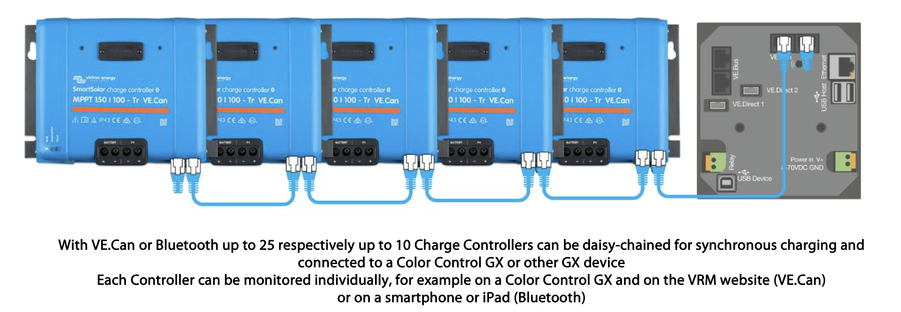

Hello,
I have 4 MPPTs and 1 BMV and I want to add them to Color Control. MPPTs have also can.
Now, what's the best way to connect them?
- all via can and BMV via ve.direct
- 3 via can and 1 via ve.direct and BMV via ve.direct
- all 4 via USB and BMV to ve.direct
- all 5 devices via USB
My question is if I can mix connection (can, ve.direct and ve.usb) or need to add all on same connection type?
Second question: How many USB devices can add to Color Control max? I read in manual that 5 is max. processor can handle. If plan to add more MPPTs need to change my GX device?
