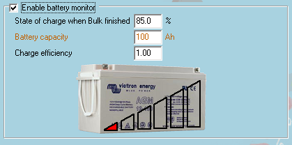

Do you have any of the three products that can calculate SOC connected to the CCGX?

valentin avatar image valentin commented ·
We have a MultiPlus 24/5000/120-100 connected to it.
Before was the % on the display, but not anymore.
I asked the company that installed, but they don't know.
We live in Spain.

markus avatar image markus ♦♦ valentin commented ·
Hi @Valentin,
Settings --> System Setup --> Battery Monitor.
Have a look after this setting.
Or maybe the SOC calculation is disabled on the Multi itself?
Regards,
Markus
0 Likes 0 ·
valentin avatar image valentin markus ♦♦ commented ·
Hi Marcus,
The settings shows the multi.
How can I change the calculation, on the multi, so it is able?
Thank you
0 Likes 0 ·
You will need a MK3 USB Interface and VE.Configure3 PC software to change this setting.
Or interview your installer about this...
0 Likes 0 ·

JohnC avatar image JohnC ♦ valentin commented ·
Markus' screen is also accessible via Laptop > LAN > CCGX. If the "Enable battery monitor" tickbox is missing then you'd need to update the Multi's firmware (with the MK3 interface).
You may well have seen SOC on your screen earlier. That may have come from the ac input to the Multi, which earlier firmwares would include - but not from the mppt. So when the SOC 'runs out' you're left with just a dotted line.
0 Likes 0 ·
