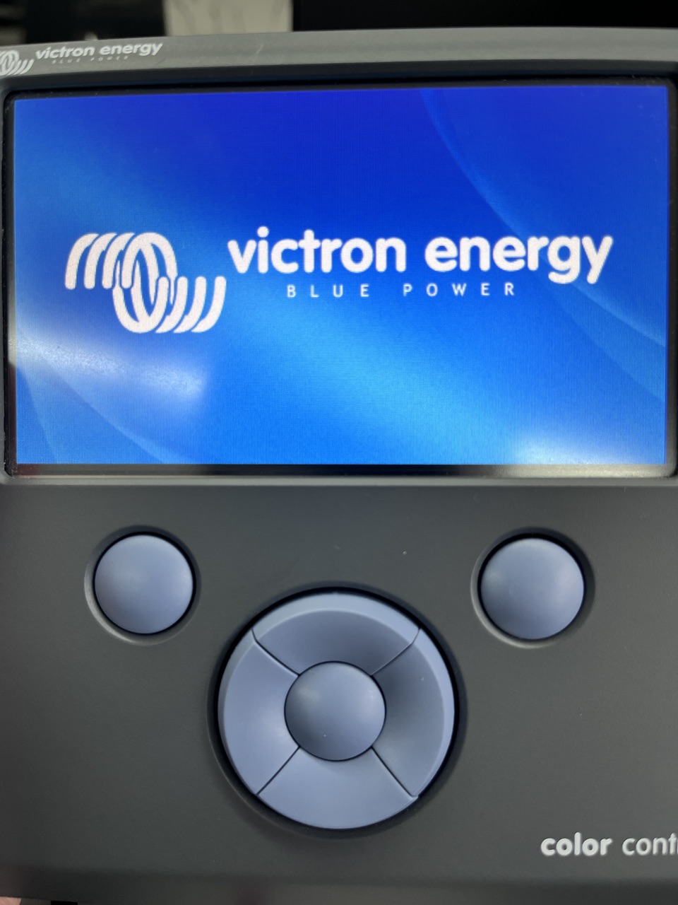

Power in is connected to 14VDC, 2A, but keeps restarting repeatedly at the initialization screen.
You can try recover/reset to factory it using an image on SD card. Also connect it to a larger power supply/ switch to a battery
