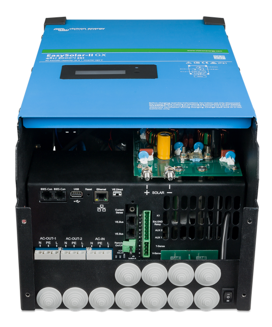

The easy solar 2 GX has a built in GX device that means you dont need the Cerbo or any other gx device.
See the picture of the unit.
