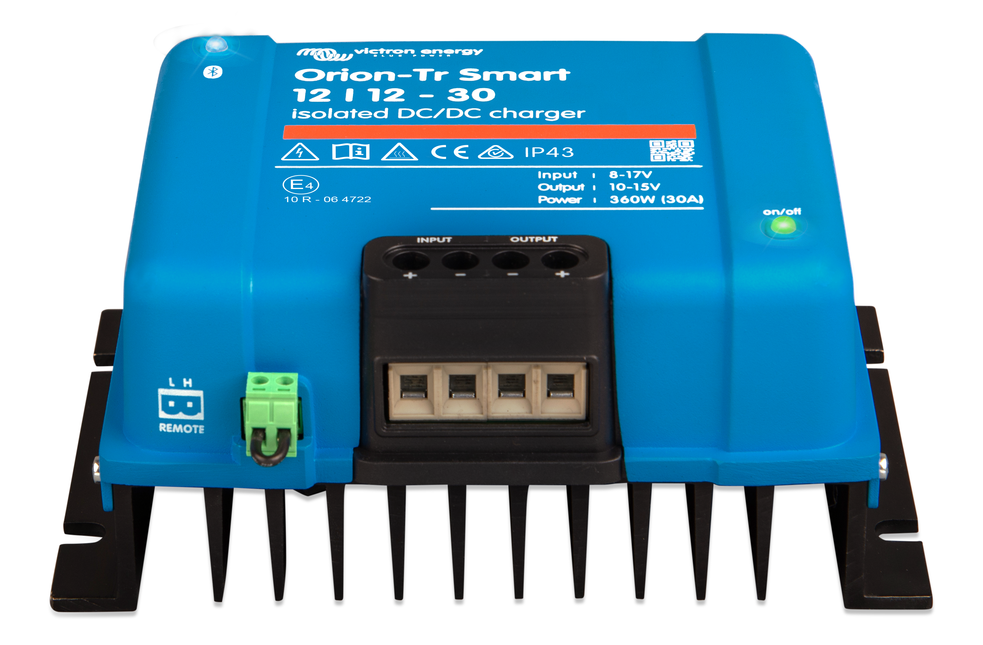

Wire the switch contacts on the Orion so it switches on and off with your ignition.

I finally got around to wiring the ignition to the L pin but it doesnt seem to stop charging once the ignition is turned off. It stays in the state it was in. Any ideas? I had to go back to using the shutdown detection in the app.

Try swapping the ignition wire to the H pin.
+ signal to H pin, or - signal to L pin to enable charge.

Yeah that is correct. I did that after i read a post and you are correct. Its H pin. It wasnt in the manual though. Thanks for the response.

I followed this post https://community.victronenergy.com/questions/79387/remote-ignition-switch-wiring-confusion.html They had the same issue.
I tested this today and indeed it does work as expected and my tests confirmed as theirs did that the h remote wire connected to the ignition does turn charging when the engine is on and off when it is turned off.

It is, 4.4b.
But not really visible/obvious. And it says a switch, should also be referring to the switched output from the ignition switch, like the one that turns the radio on.
By the way, did you turn on the smart alternator setting when you configured the Orion? Guessing you did.
There's also an engine on detection manual.
