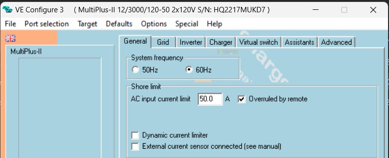

Has the Multiplus ever been programmed to allow the shore power limit to be over ruled by remote. See VEConfigure3 settings screenshot, the tick box needs ticking for another device to alter the shore power limit, otherwise it stays with what is set in the Multiplus.

I was able to download the settings for my MultiPlus II and view them in VE Configure 3. The Overruled by remote setting was set:
Any other thoughts?

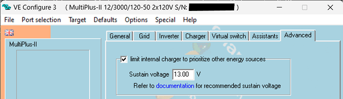

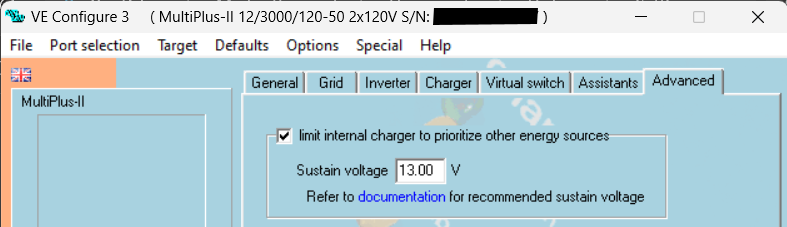

I finally got it to retain my shore current limit setting - but I don’t know why this fixed it. As I was reading all the literature, I saw info about enabling Solar & Wind Priority which was something I wanted to do. I went into VE Configure 3 and changed the setting to allow that:
I then uploaded the new config to the MultiPlus II. After doing that, there is a new setting in the Controls for “Charge Battery to 100%”. While I was in there, I also tried changing the shore current limit from 30A to 15A - it stuck! No idea why that did it, but (at least for now) it’s working.
