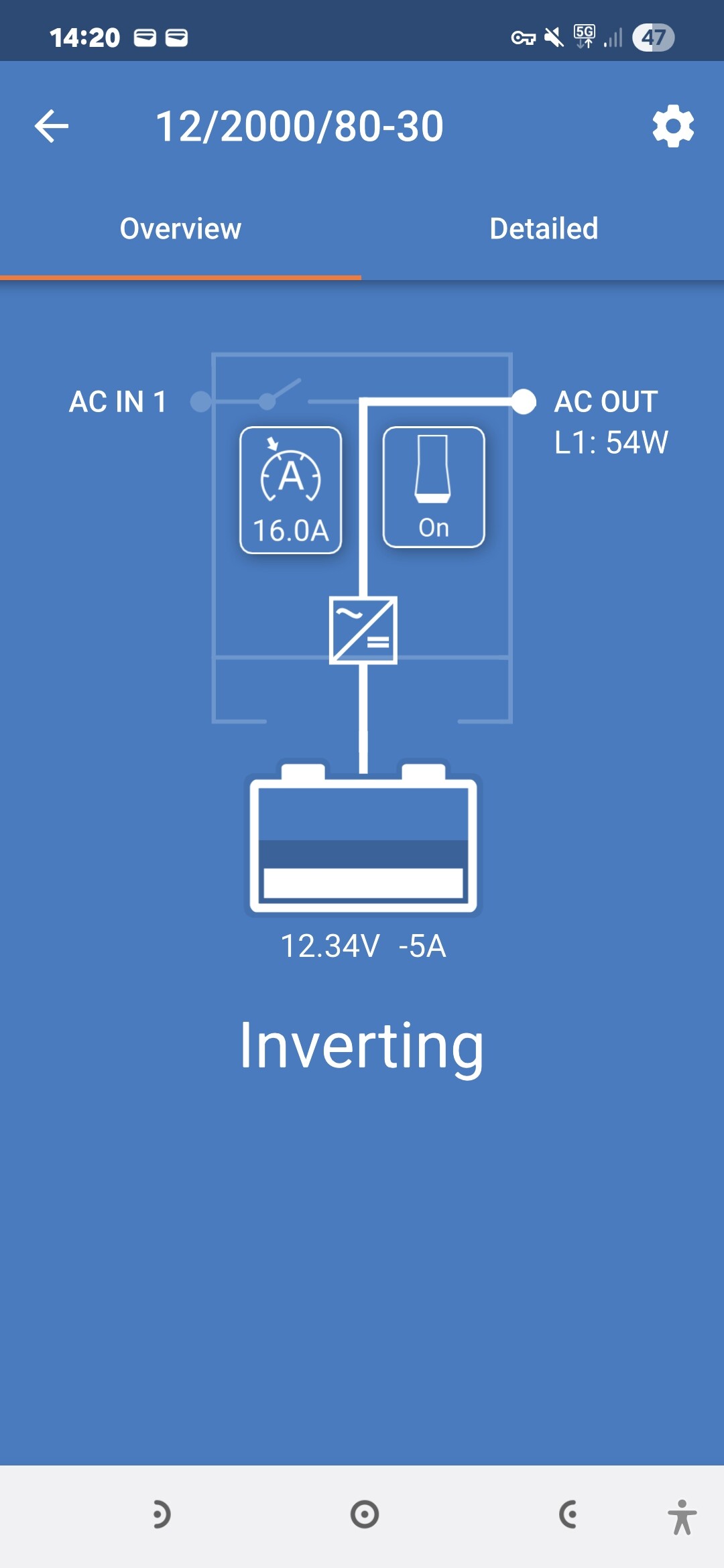

So remote works. I also have the adapter for phone to see what happening with unit. It only takes ac from shore power when charging, other than that all the time is inverting mode.i thought the ac should be ‘let through’ all the time there is supply.
Still not understanding what is happening here. The design of the Multiplus means that as long as ac input is accepted then it has to pass through. It is as if yours is set up to ignore ac when not charging. Do you have any assistants set up.
Could you capture screenshots of your settings.
This was what phone shows, to get further settings a password is needed it says. It seems the unit is not allowing the ac to go straight through for some reason..
