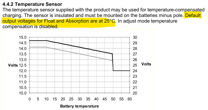

In VE Configure I can change the Temperature compensation. If I set the compensation to -15.6 mV/deg, I will get a maximum abs. voltage at 15.5V. This is what my battery supplier recommends, as max abs. voltage. (Tudor/EXIDE TR350/ER350, lead acid) But they also recommend me to set the temperature compensation for -30mV/deg.
Their reason for a max abs voltage around 15,5 is that equipment in the boat can be damage with higher voltage.
So, to my question: Is it possible to change the max abs. voltage after temperature compensation, or just put a limit. I still want 14.8 V at 25 deg.
