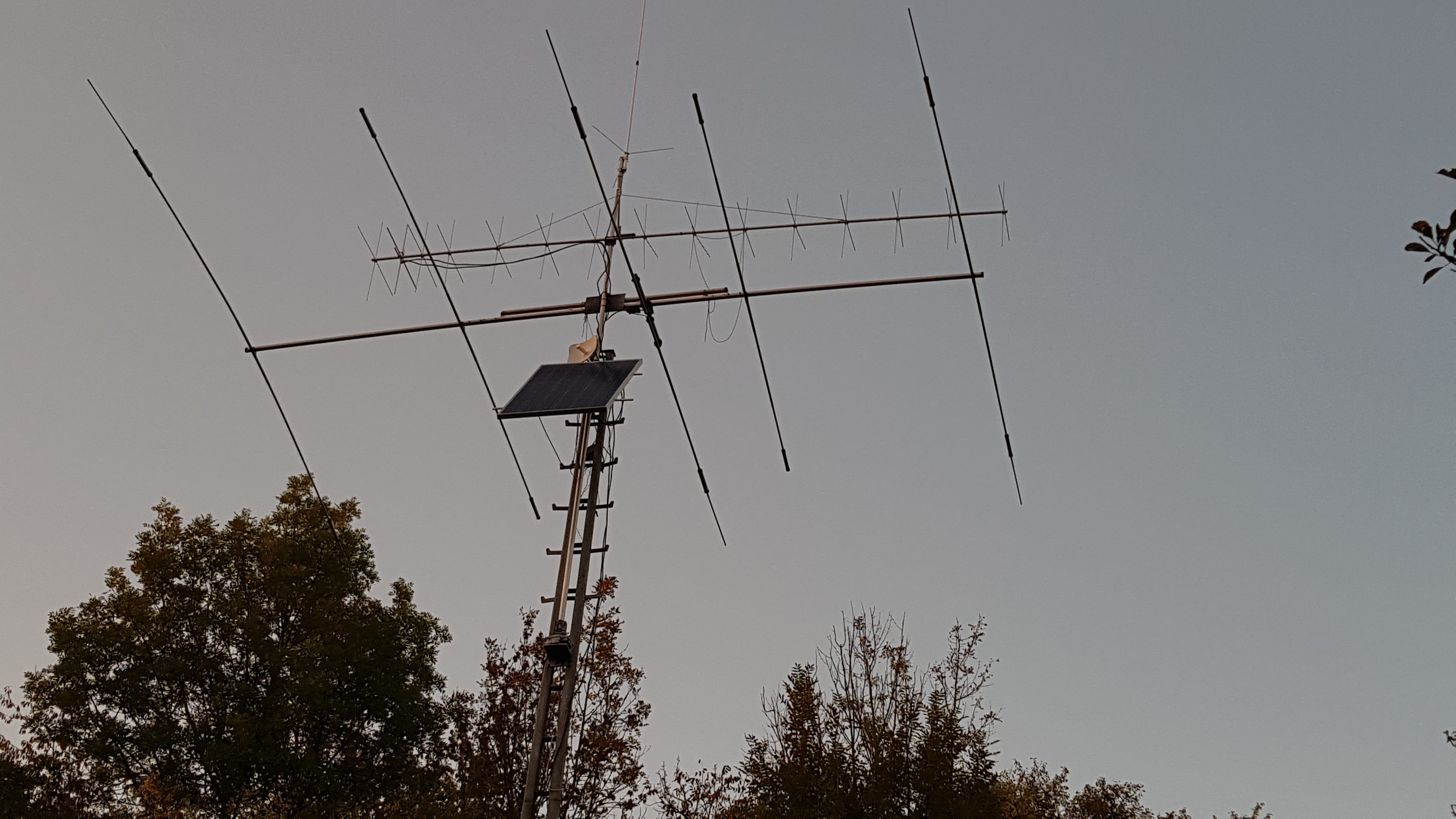

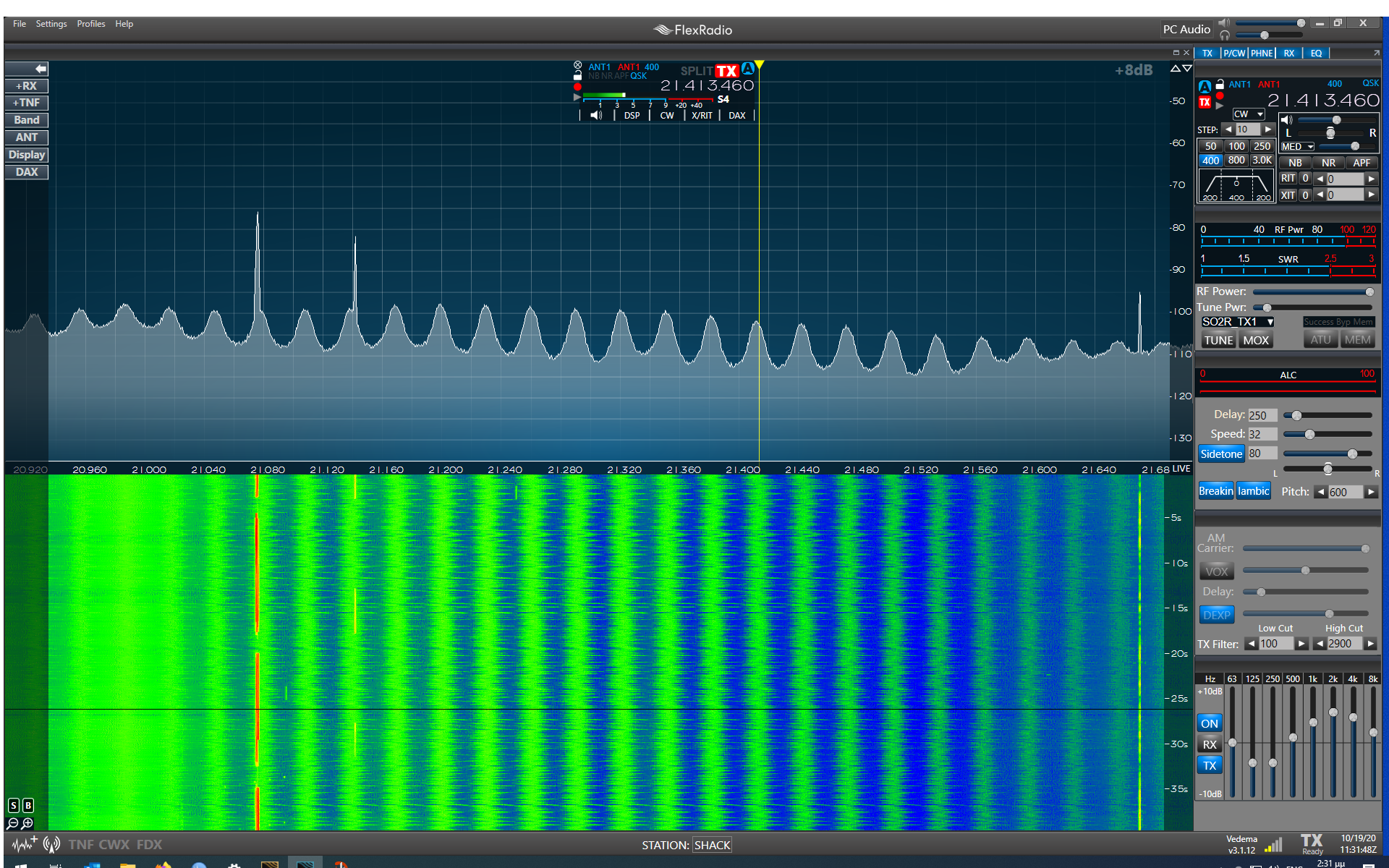

Dear friends, just finished my remote HF station running on solar energy and a big disappointment on 21mhz.All band during day time is unusable due to LO RFI of my MPPT 100/30 charge controller.
