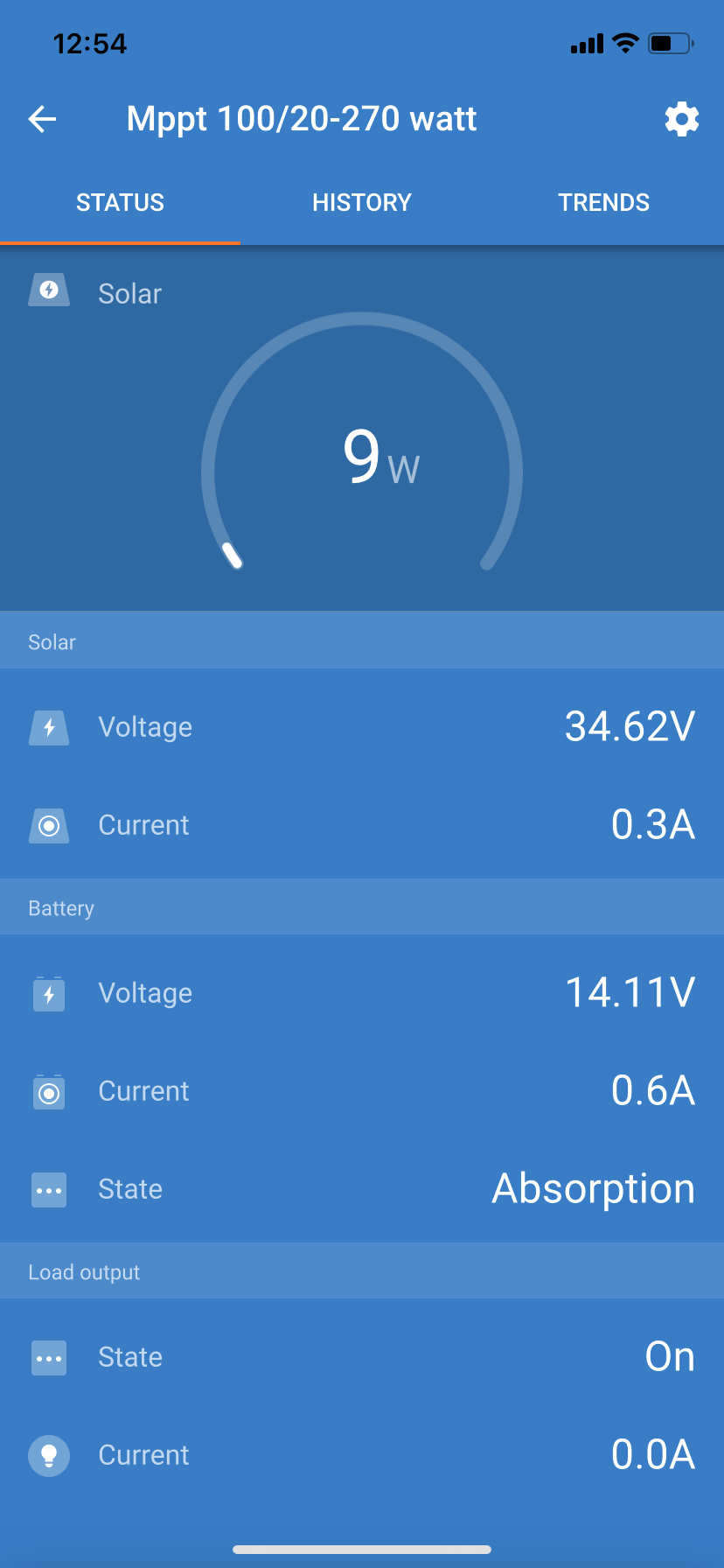

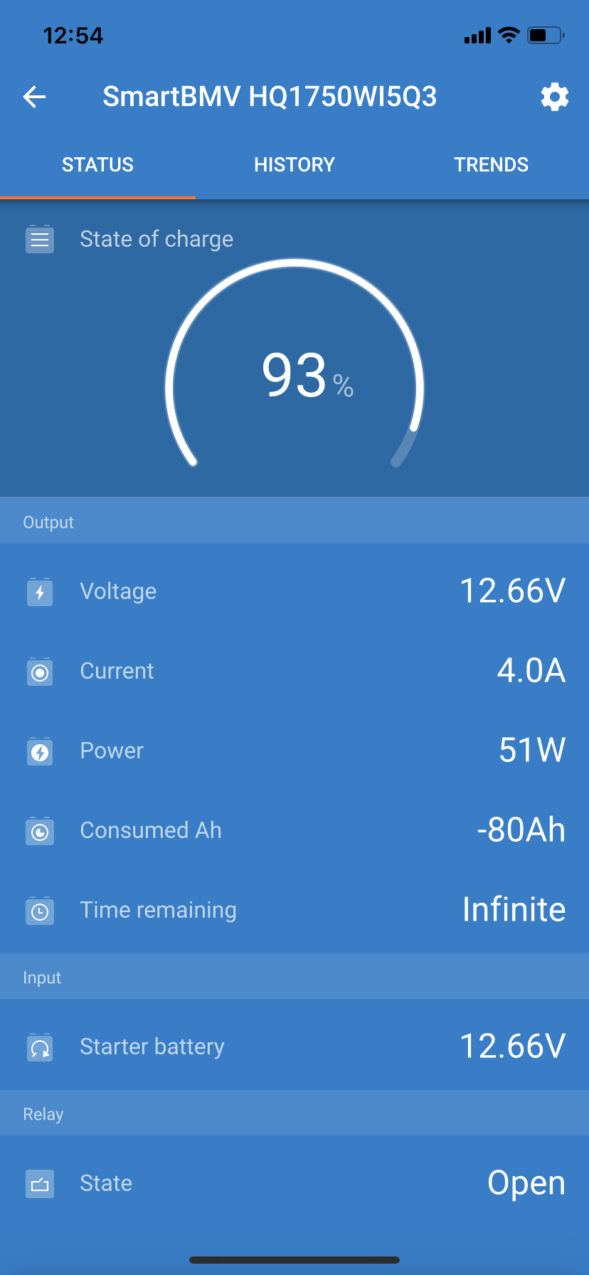

I have the 20ah solar charger and a smart bmv monitor. Usually things work at expected - hit float sometime most afternoons around 14.2v and sunrise around 12.3v. However every now and then I'll notice the charge controller reading the battery at float in the morning and not charging all day. Example attached. The BMV reads the actually battery voltage correct. I've reset setting to factory, turned off charger and turned back on via the Bluetooth battery settings, checked wires, and nothing seems to fix the issue (the charge controller reading the batteries at float when they are far from it. Current firmware. Any pointers or ideas?
