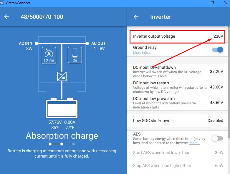

We need to increase the inverter output from 220V to 250V
@rmadden, I'm not even going to ask why you need to do this... just keep in mind that this is a very dangerous thing to do, and can potentially cause all kinds of problems in your system if you don't have an exceptionally good and valid reason for doing so.
That being said: Connect your MK3, open VictronConnect>Settings>Inverter, and click on "Inverter Output Voltage". The maximum voltage you can adjust this to is 245V, so hopefully that's close enough to what you need.
Please be exceptionally careful and understand that doing this might well release the magic smoke from anything that you have plugged in.

Thanks for your amazingly quick response Justin. It was very much appreciated. I am asking for my father who is sitting next to me :) At the moment our inverter is only 220 and the manual says it can go to 245v so we would be happy with this. I think the issue will be that my dad doesn't have the inverter connected to a computer at all. Is there any manual way to make this change or will he need to get a technician out. They live in the Kimberleys in Western Australia
@rmadden hmmmm good question... is the Multi connected to the internet via a GX device? I believe this should be possible to remotely set through the VRM... I haven't ever tried doing that in particular, but it should be possible.
Otherwise, no, you'd need a technician out or get yourselves an MK3 to USB Interface so that you can program the Multi as needed - I'd recommend the latter, since the MK3 is certainly going to be cheaper than a technician :-P
Thanks Justin. OK so please don't laugh too loud, but my father has asked what a MK3 is and what would it look like. He has said that 'MK3' sounds familiar so maybe one came with the inverter and it is still in the shed in the 'not sure what this thing does'pile
