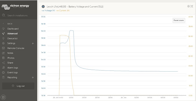

- Hi,
I have gone through the posts, but were unsuccessful in finding an answer. If I missed something, please direct me.
My victron system charges the 400A freedomwon lithium upto 14v/100%. As soon as it reaches 100%, the voltage drops to about 13.4v/99%, and the process repeats itself.
The orion b2b however, charges the battery to 14.2v and keeps the voltage constant-no voltage drop.
Freedomwon has checked on their side, and can find nothing wrong. Any ideas?
The system is on a sailboat. We have three methods of charging: shore power, solar and the b2b connected between starter battery and lithium.
How can I get the system at a constant 14.2v without the endless loop of discharging and charging?
Any help would be greatly appreciated.
