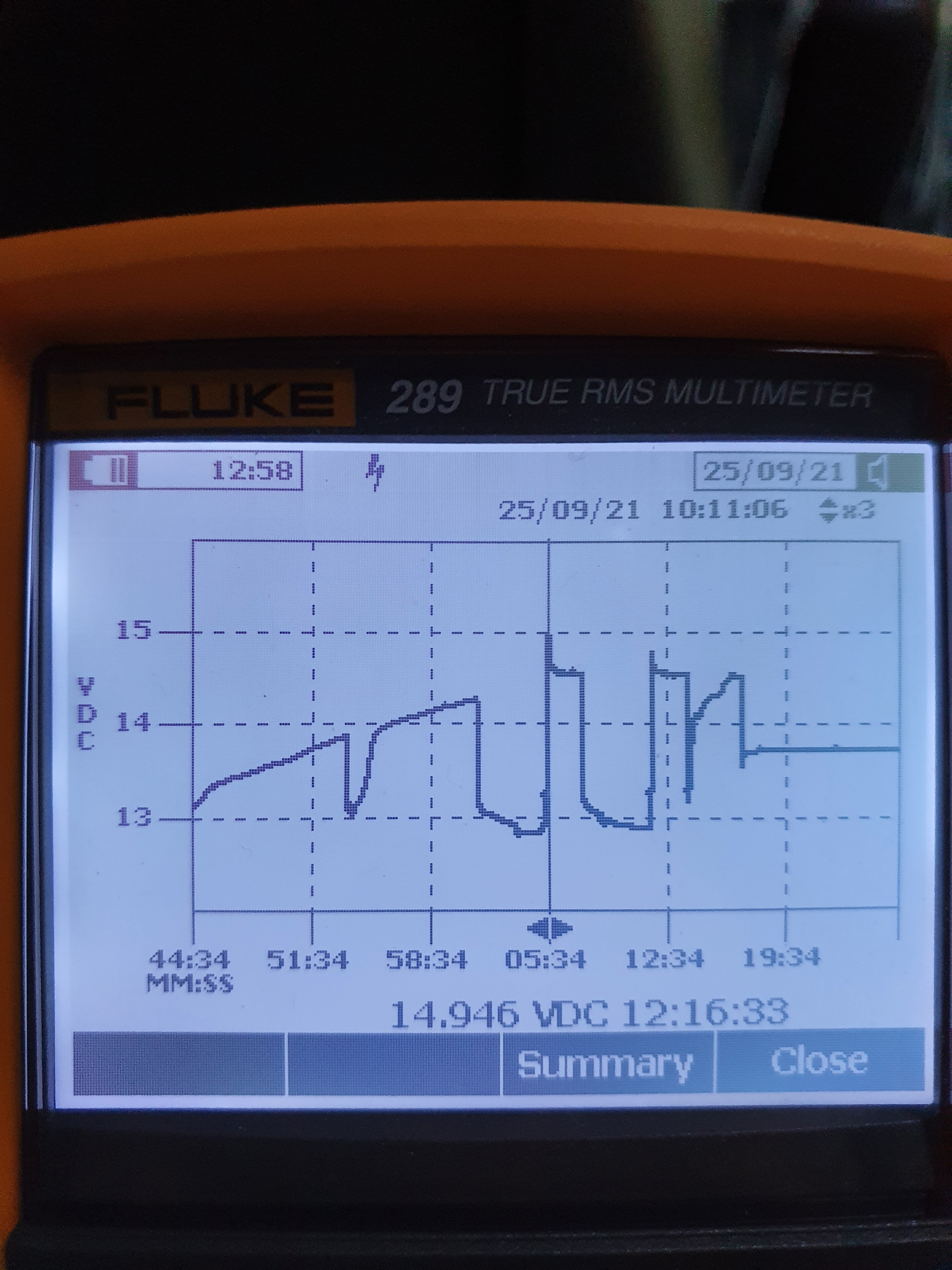

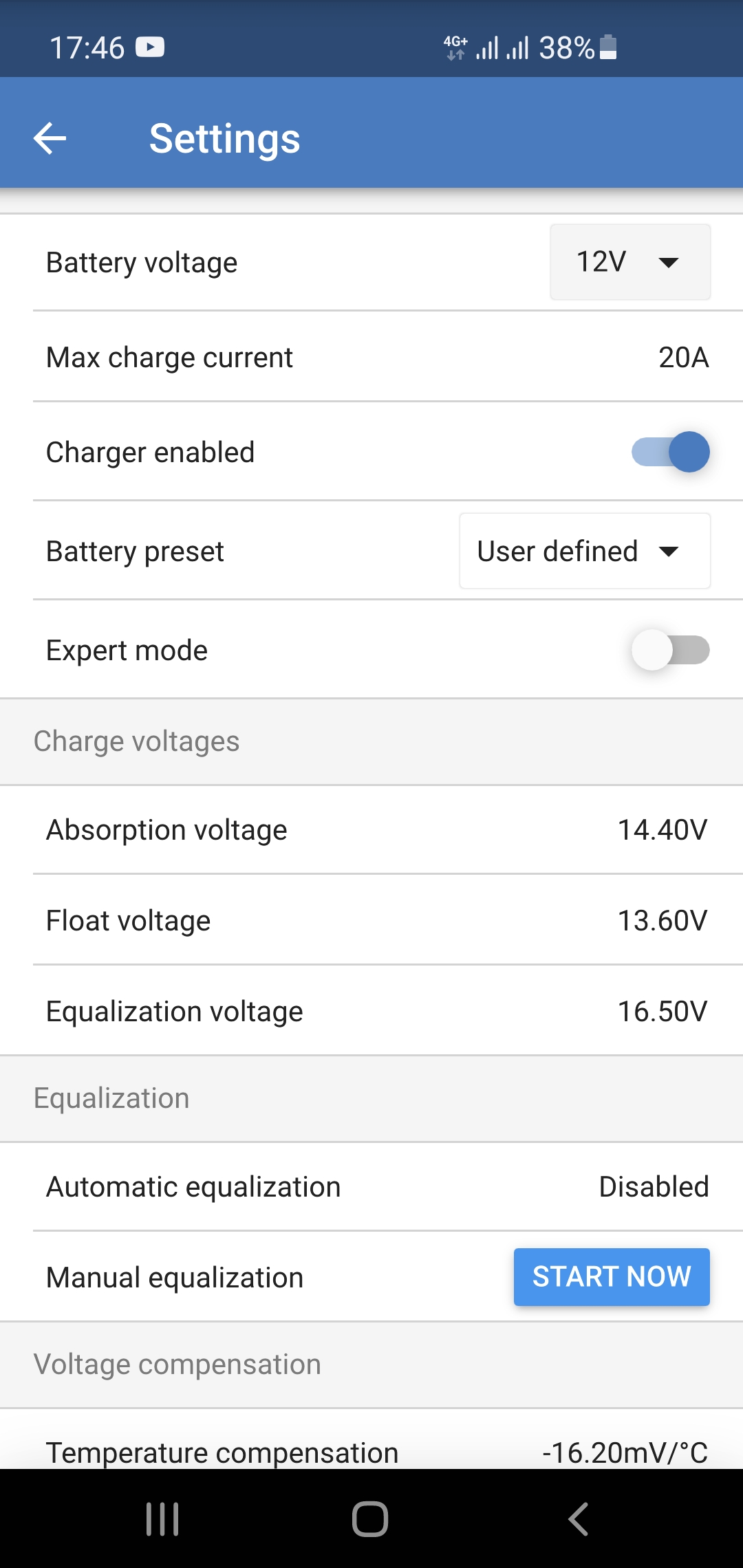

in my camper I substituted the PWM charger with a SmartSolar 100/20. Since then, my Whale heater signals frequently an over-voltage-error (>= 15V) despite that the absorption voltage is set to 14.4V.

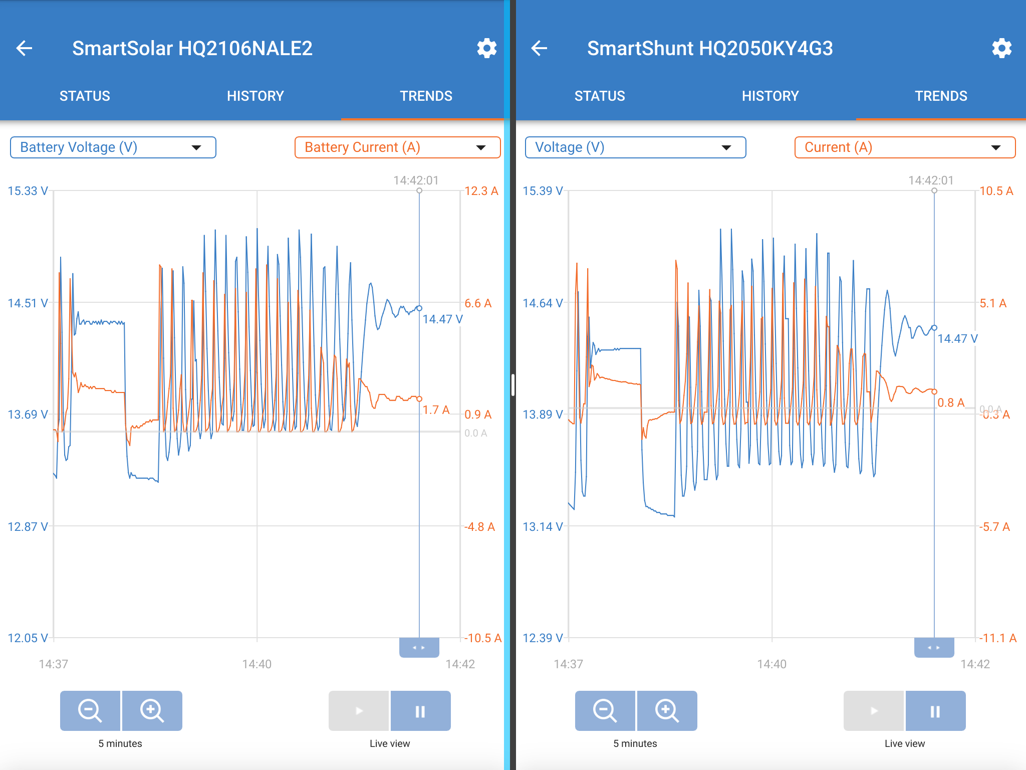

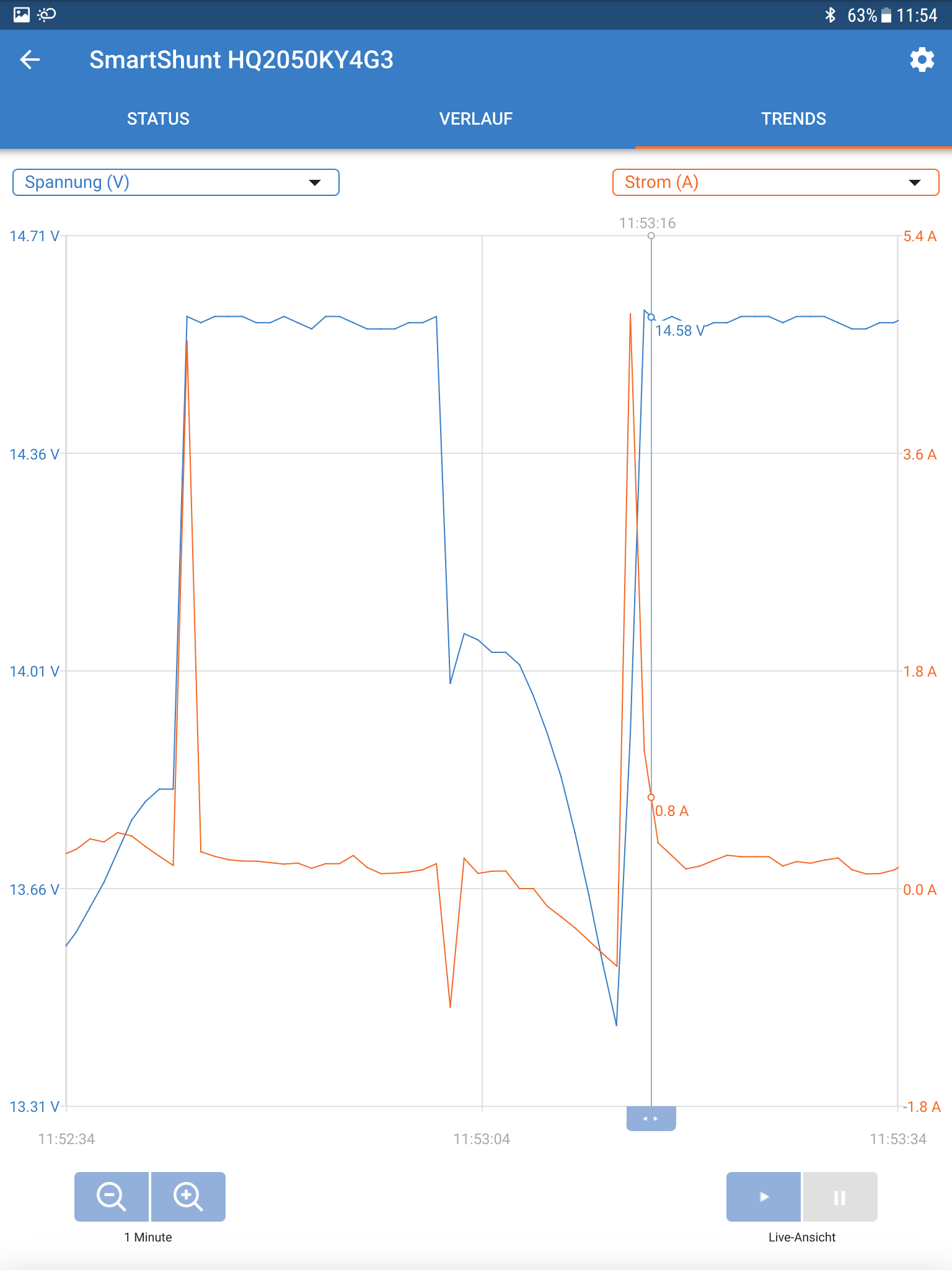

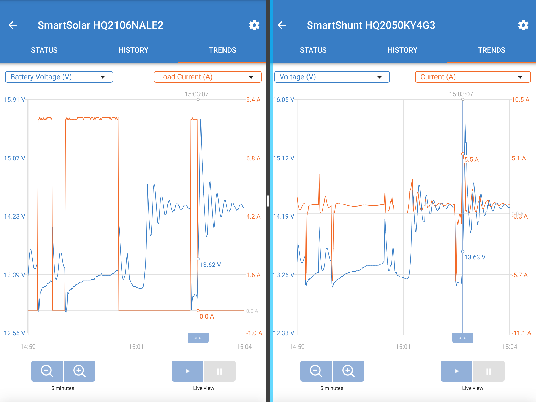

A tracking of the battery voltage has shown, that there is indeed occasionally a spike up to 15V.
What can I do to fix the problem?

Additional information: the SmartSolar receives Voltage, Current and Temperature from a SmartShunt via Bluetooth. I did not test if this leads into timing issues.
