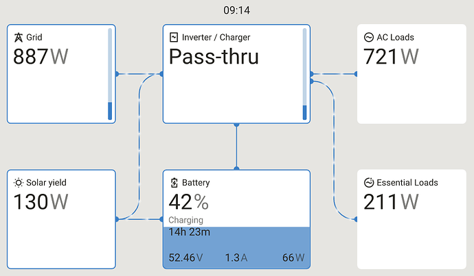

I have noticed a weird display issue in VRM and also in Remote Console.
I have a Multiplus-II GX inverter with SolarEdge Inverter connected on AC-In side.
I use mu multiplus mostly in Offgrid mode, using heavily the IgnoreAc option (controlled via NodeRed).
I have grid meter installed but do not use ESS because I cannot feed into grif any single watt from multiplus. As the built-in GX does not have any externaly controllable relay I use the relay of my MPPT to control aux input in Multiplus to steer Grid Charging enable/disable from NodeRed (by controlling MPPT relay). This works excellent except for one display issue.
The issue is - when in IgnoreAc - both VRM portal and Remote Console is wrongly displaying my PC Inverter on Ac-Out side of Multiplus. Grid meter shows real grid production/consumption, but critical loads calculation is wrong as it is summed with power produced by solaredge.
When I switch off IgnoreAc, then solaredge “jumps” to ac-in side as it is configured all the time, and critical loads are calculated correctly.
