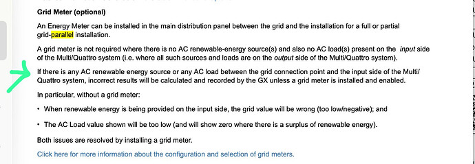

an additional grid meter is needed to prevent this issue!
