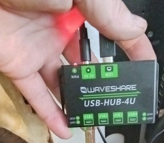

I ordered a powered USB hub for further testing:
  • It is now possible to use a shielded 2 meter USB extension cable between the hub and the USB GPS. Before the GPS would either not be recognized or disconnect within a short period if time.
  • Unfortunately this does not solve the 2nd VE-Direct connected BMV not being recognized after (beta) firmware update with a/the USB device (hub, gps or otherwise) connected
  • A plain reboot, not unplugging USB, did resolve getting the 2nd BMV recognized. Not unimportant in remote update context.

  • Moving the 2nd BMV connection from the 2nd VE-Direct, back to a USB to VE-Direct (duppa, quad isolated USB to rs232) connection, but behind the powered USB hub this time, resolves all reconnection issues (for now).

  • Do use a good powered USB Hub with a short USB cable to the MP - GX
