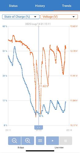

A few days ago, I woke up to find my PWM BlueSolar controller had shut the system down, because the batteries (2x 100ah lithium) discharged to almost 9%. Weather conditions had been good (very warm and sunny) for weeks, so I was quite surprised to see this in my Smart Shunt data:
The graph is showing a few periods of multiple days of not charging at all (and very random too - charging started again at 4PM the last time this happened). In addition, the daily charge being put into the batteries keeps declining (even though weather conditions are stellar). It says the batteries have actually never really been above 51% charge, and the last few days it seems it’s being “capped” at 17% charge.

The most common cause of poor charging, especially in boats and vehicles is poor connections, often loose connections from vibration. Check controller to battery wiring, both positive and negative. If there is a loose connection this creates voltage drop so the controller sees a higher voltage and reduces charging. If you have a multimeter check the voltage at the controller terminals and the battery terminals when charging, they should be the same.
Other thoughts, dirty panel, hot panel as output reduces as the panel gets hotter, you have left a load on that you have not found. The above would not cause the controller to delay start up though, hence my money is on wiring issues.
