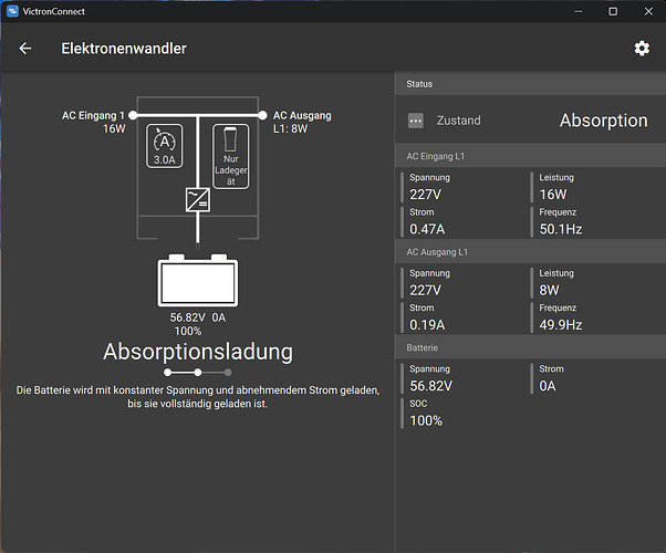

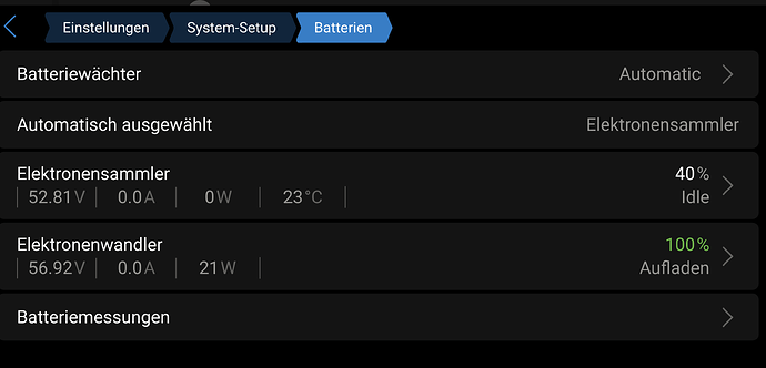

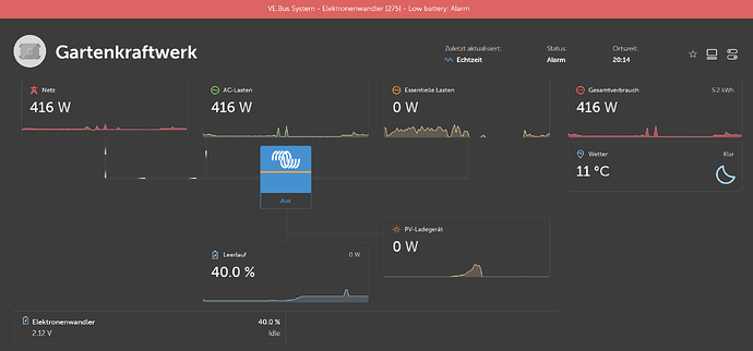

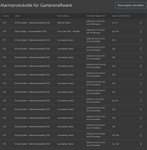

A few more screenshots for reference:
It’s sorted now: it was an undersized 30A fuse between the battery and the Lynx. The inrush current obviously put so much strain on the fuse that it blew. It was barely noticeable visually; you only see it once you unscrew it, so I didn’t realise that was the problem at first. It was only after I took the time to go through a start-up procedure and take measurements with a multimeter that I noticed the faulty fuse. :melting_face:
