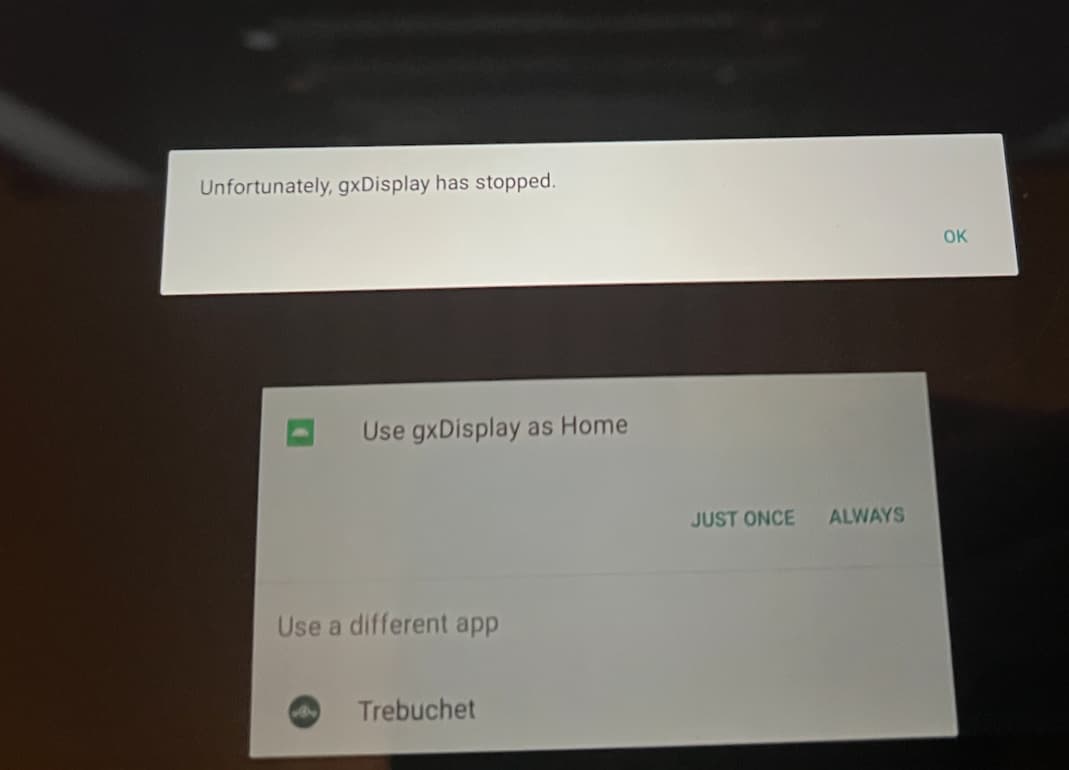

Unfortunately after reboot app shows main menu with wifi connected, but crashes as soon as I click “Select device”. Android 6.01 (Lineage os 13 on resurrected mi pad 2). Installed from APK, no way to read QR code while activating tablet.

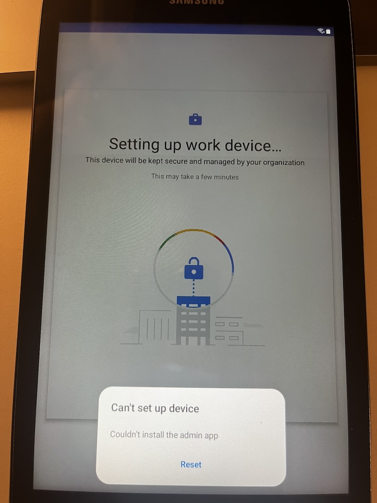

Unfortunately, does not install on Samsung Galaxy Tab A (SM-T380) with original software - restored to the defaults of course.
After initiating the procedure by scanning the QR code, it displays some informations about setting the device to be managed externally, and … after couple of minutes it says “Can’t set up defice. Couldn’t install the admin app”. The only option here is “Reset”, and it brings the device state to the factory setup.

Were you able to solve your issue. I have the something happening , tried using the QR code and downloading the apk same results.
Doesn’t work on a Lenovo TB-7305F (Tab M7). I get the same messages as another poster on here: “Getting ready for work” and “Couldn’t install the admin app”. The tablet has Android 9, screen resolution of 600 x 1024. Doesn’t install from the apk either.
