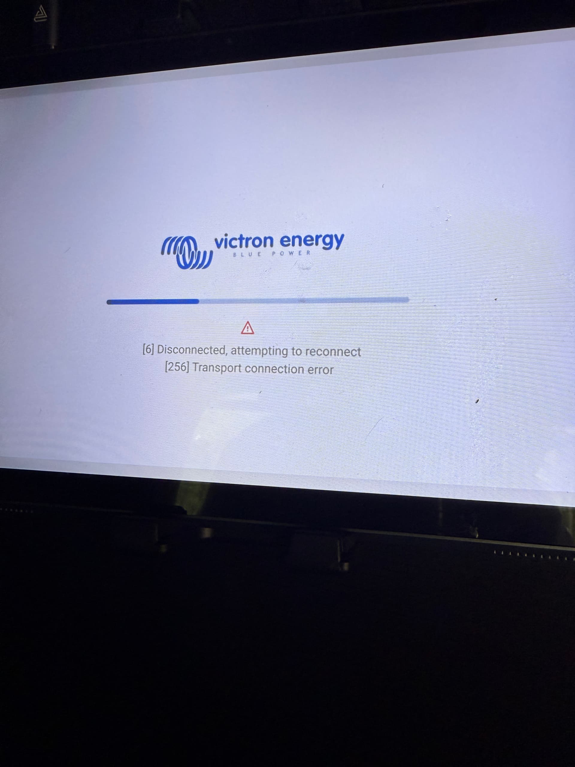

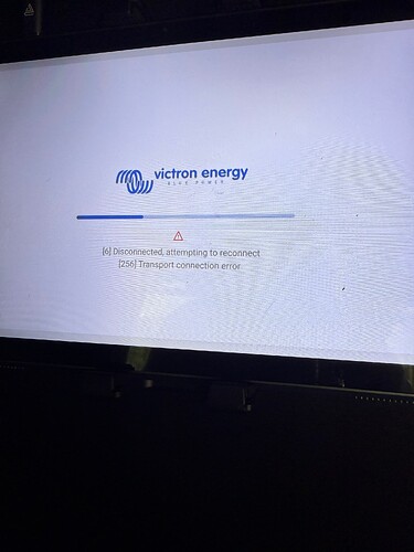

When used with a GX device that has a password set for accessing it over the network. After about a day or so the Android display will stop showing the GX device status and show the following error
"[6] Disconnected, attempting to reconnect"
"[256] Transport connection error"
I have Android GX Wifi Display installed via QR code method on a Samsung A9+ tablet running wifi gx display version v1.00.
I have to open the service menu and tell it to reload a few times before it will then bring up a page asking me to login to the GX device again
If I login then it will work fine for another day or so and then show the same error shown in the first photo above.

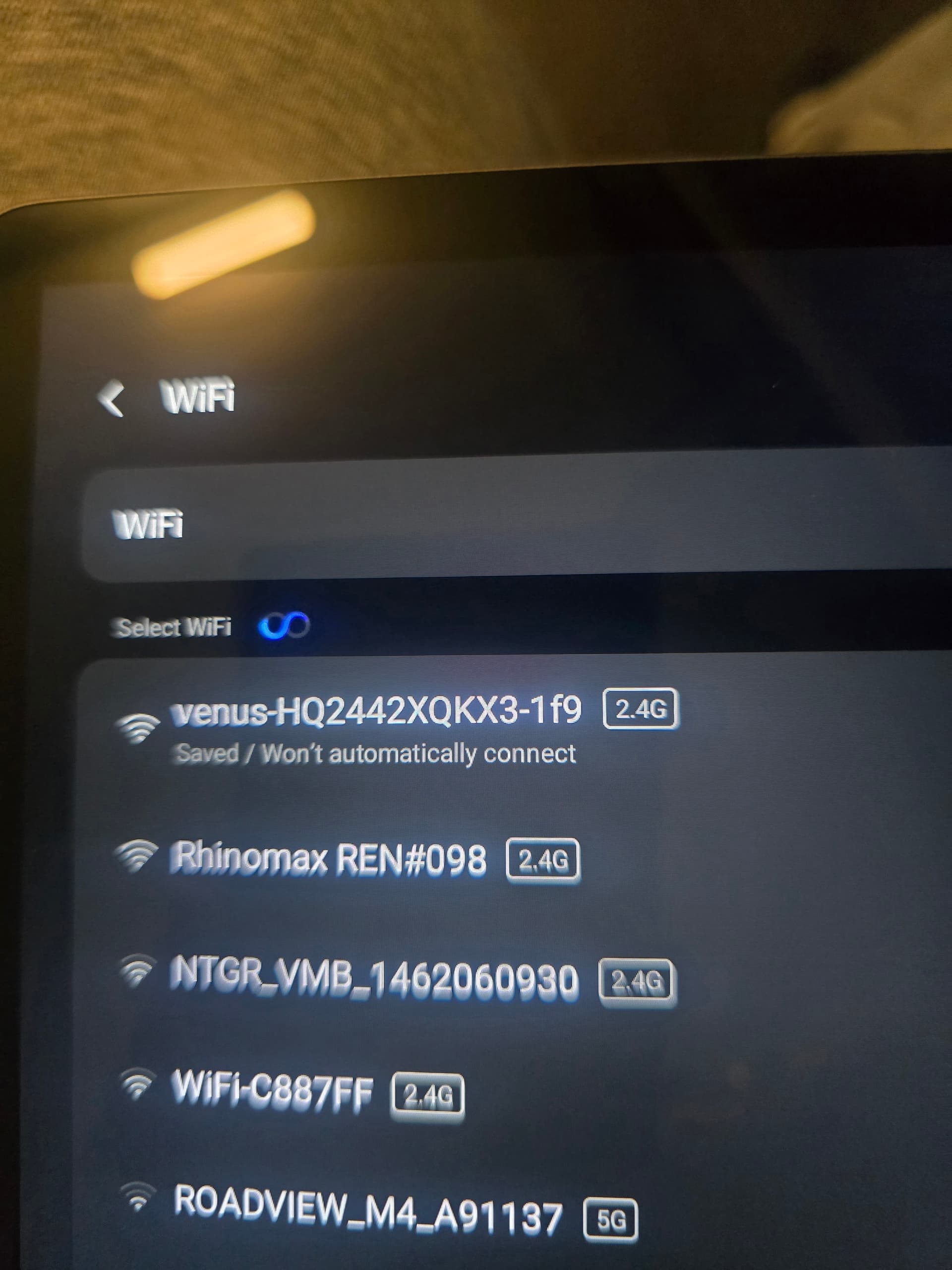

Getting the dreaded (happens randomly):
[256] Transport connect error.
I usually have to get back into the WiFi and again select the Cerbo and connect.
I also noticed the below - The WiFi is saved, but “Won’t automatically connect” message as per below
(yes, have the Auto-connect tab selected)
Is the app installed via the QR code? If that is the case try this:
  1. Forget all the WiFi networks
  2. Go to the app WiFi settings which is in the hidden menu (not Android Wifi settings)
  3. Connect to the Cerbo WiFi
Some Android devices ignore the auto-connect if the selected WiFi access point has not internet connection.
Something that seems to help overriding this default Android behaviour is to switch on Airplane mode, then enable wifi and connect to the Cerbo.

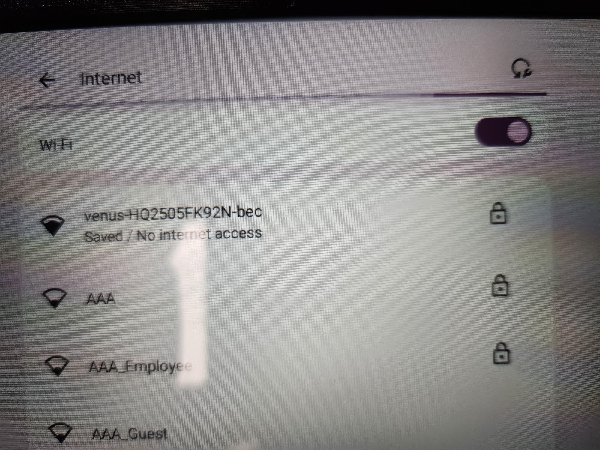

This may be my problem. Auto connect is on and the connection is saved. I looked at the wifi settings and it saying no internet connectivity. If I click on the network it connects. I’ll look closer at the steps you suggest and see if they help.
I tried the suggestions to no avail. Tried a static IP with same random results. The M8 wakes up and connected OK sometimes but not others.
