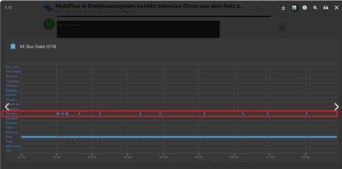

The grid setpoint value is set to 0 W in both the video and the screenshots.
You can clearly see in the 2nd image that the system has switched to “Passthru” mode. This shouldn’t normally happen and may indicate a communication problem with the BMS. In this case, the Multis pass through the required current and you end up drawing power from the grid.
It would be interesting to see some other charts from the same time … Have a look at your widgets and see if you can find any battery data that might be useful to us …
