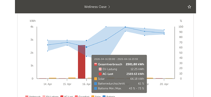

Hi, lately I’ve been repeatedly seeing very high, unrealistic peaks in consumption (approx. 2500 kWh) for very short periods.
Does anyone have any idea what could be causing this?
Setup: 3x MP2 5000/70, 2x MPPT 450/200, Cerbo, EM 24 grid, EM 540 for PV with 2x Hoymiles HMS1600W on MP Out 1
Best regards, Matthias

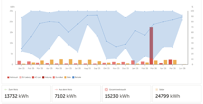

Here’s what it looks like since 01.01.25
At least the figures seem to add up. I keep seeing this mentioned here, but I’ve never understood how it comes about, or whether it all adds up in the end. I think the values are being backfilled here.

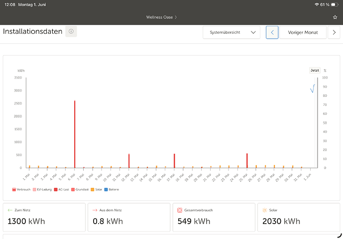

On 6 May alone, it shows 2,500 kWh :cry:

These spikes occur when the energy meter, which normally only ever increments, briefly returns a “0”: 5001, 5002, 0, 5002 → bam, 5002 kWh in an hour.
(Of course, this can also happen with any other outlier value — but 0 is responsible in 99% of cases here :slight_smile: )
How have you connected the EM? If you’re using Node-RED, you must NOT initialise the Node-RED meter with defaults, otherwise every time Node-RED restarts, a “zero” gets into the system.
It’s also a good idea to use a filter that blocks any 0 coming from the Shelly or MQTT.
