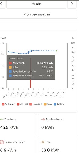

Loads – very high, unrealistic consumption peaks
I’ve now disabled all the other meters apart from the EM24 grid meter. I’m still seeing peaks of nearly 3000kWh. It’s great that they aren’t being added together, but it obscures the others.

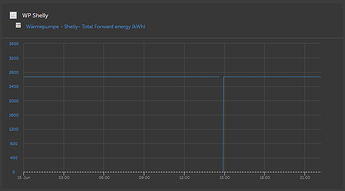

this is the Shelly for your heat pump — it sometimes reports a “0 meter reading”, which triggers a reset in the analysis. Then, as soon as it reports the correct 2666 kWh again, the analysis interprets that as 2666 kWh of “consumption” in that minute.

In general, though, there are meters that deliberately reset to 0 — after a restart, at regular intervals, when the maximum value of the register is reached, and so on. The energy calculation handles that as intended — only unintended “zeroes” are false positives and should be avoided.
So we’d need to identify and “fix” the exact cause, which is why I asked how the Shelly is connected. Third-party scripts are unfortunately sometimes not protected against “zeroes” if, for example, there’s an MQTT reconnect, or some part of the system turns null into a 0, etc.

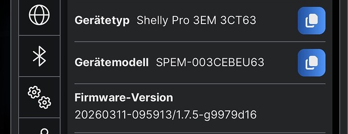

It does get tricky, of course, if the Shelly itself is the cause. The EM3 has cropped up in a few threads, whereas, as far as I remember, the PM Shellies never have.

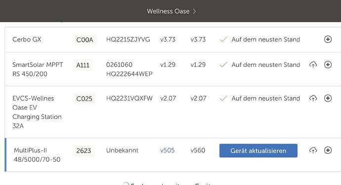

and “Cerbo GXC00A HQ2215ZJYVG v3.73v3.73 Up to date”
I’d almost bet that Victron doesn’t test this combination of firmware.
For cost reasons, you have to focus on current versions when testing.
Since I come from a software development background, I’ve got into the habit of installing new firmware about two months after its release.
That saves a lot of hassle with computers, and so far it’s worked well for me with Victron too.
