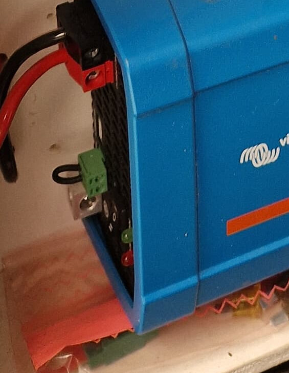

When I turn the fridge on, it doesn’t work and the inverter (Phoenix 12 500) gives an error message: green blinks 2x per sec, the red 1x per sec. When I turn the fridge off, it goes back to normal (green led only).

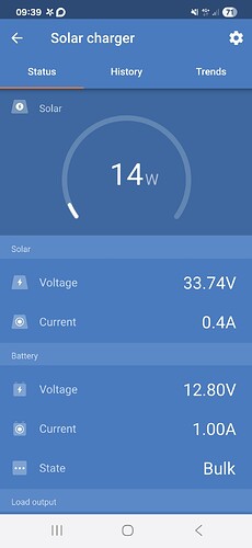

I try to attach 2 photos, the first when I turn on the fridge, and the second after turning off.

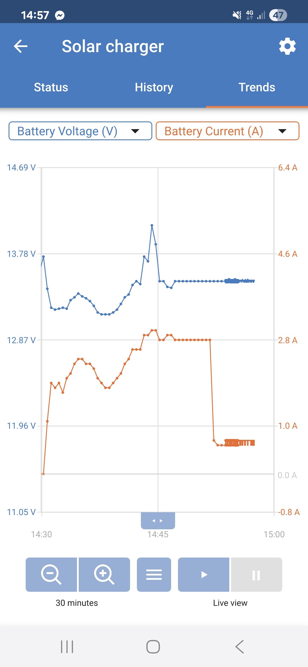

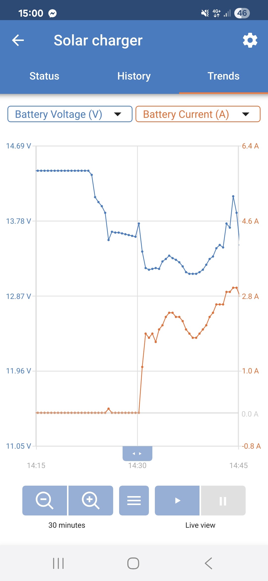

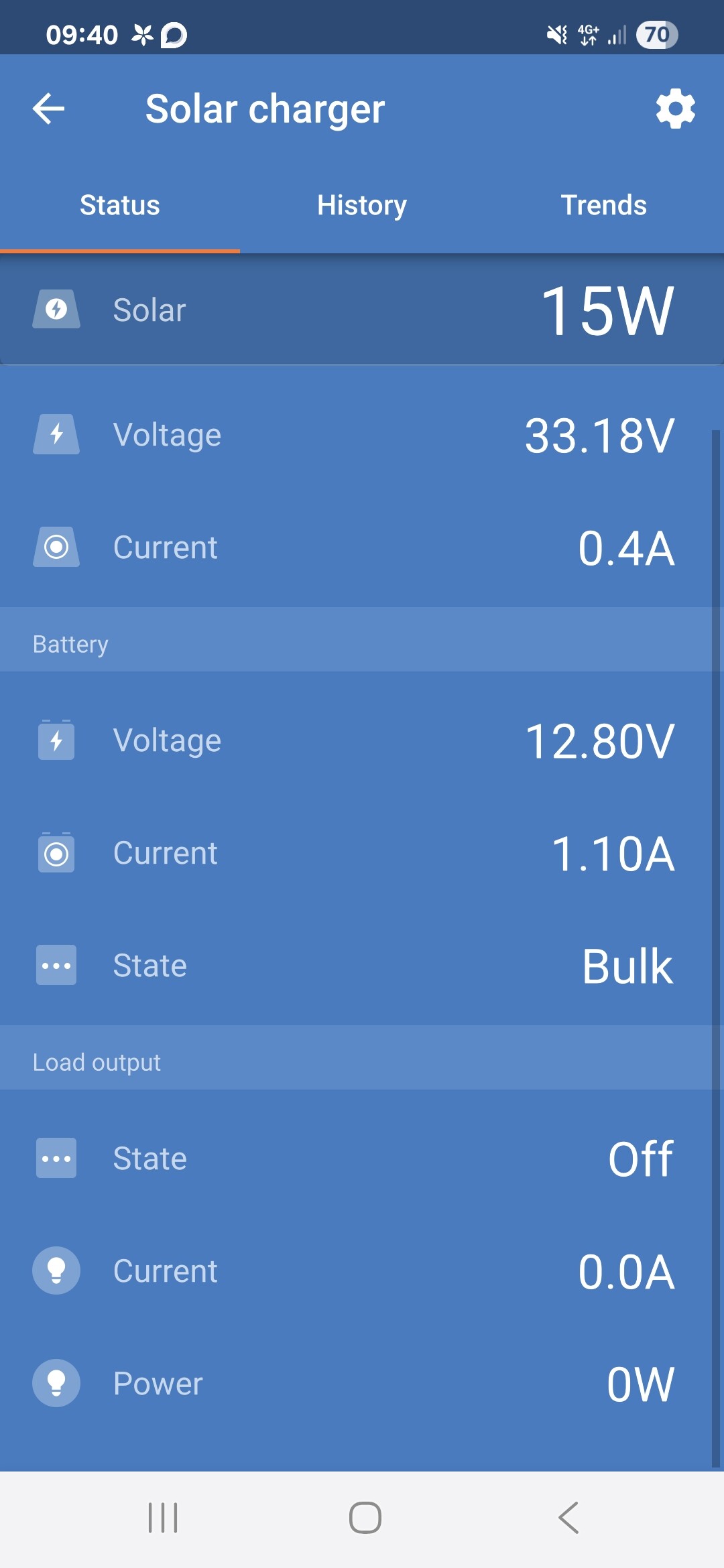

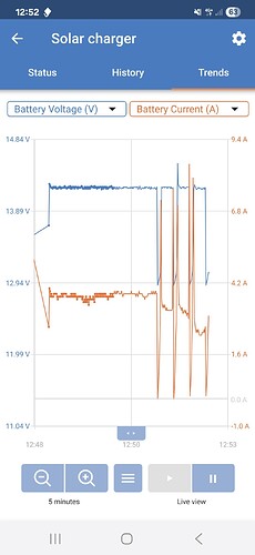

I’m looking at your screenshots and wondering why the ampere curve drops so much.
Is the inverter connected directly to the battery and not to the load output of the solar charge controller?

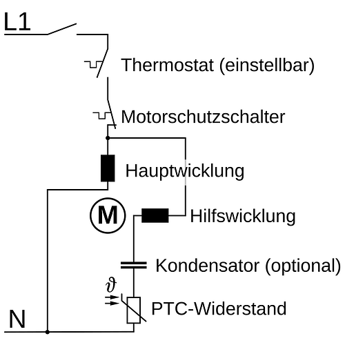

Refrigerators with PTC start-up seem to have a very high start-up current. These often drive you crazy.
Modern, speed-controlled refrigerators seem to run without any problems in this regard. I already had a large household fridge-freezer combination running without any problems on an old 375W 12V Phoenix inverter. I can only recommend testing it beforehand.

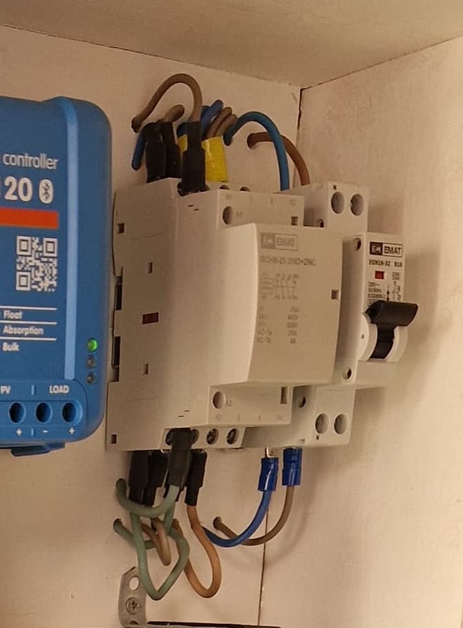

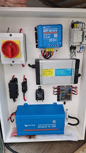

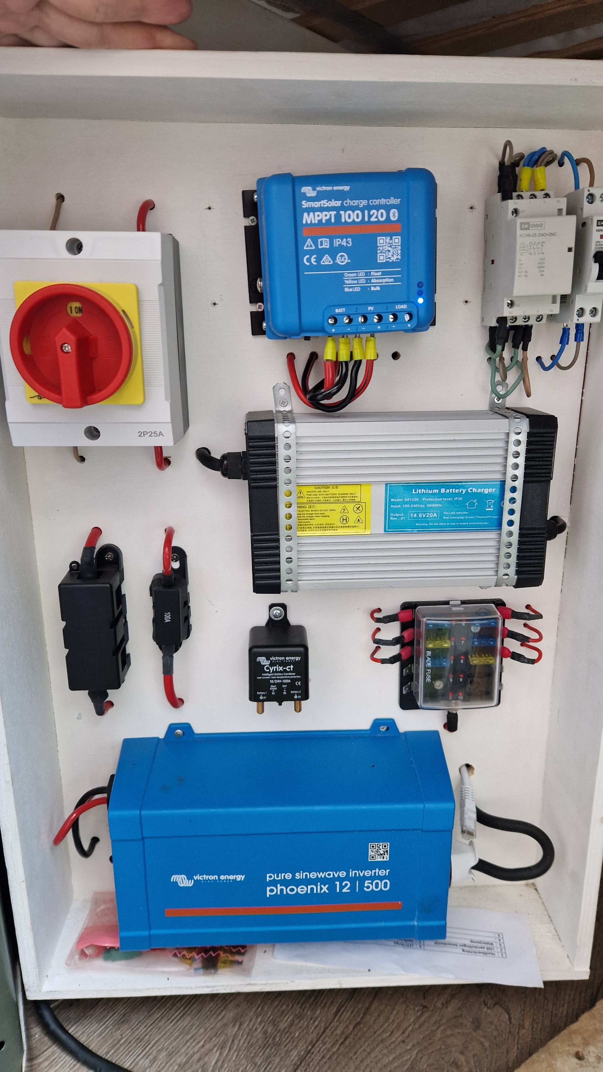

Thanks! I don’t really know what are the connections in the background. The setup is neatly organised by the previous owner who built the camper. See picture please
The battery voltage takes a dive, if you have a way to look at the phoenix settings (ve direct to blue tooth) it may have dynamic cut off enabled, that could cause a shut down.
Clean layout…almost like a dance hall
@lxonline Could it be that the cable cross-section is too small?
@Hofbrau have you a picture from the other side too?
500w at 12v is 40 or so Amps. So it doesn’t need to be huge unless it is a long length. 10mm will do. 16mm if its a longer run to the battery.
I have a12/800 and i do have to say the thing spikes to overload when starting the fridge up. Fridges can be evil loads. I have 25mm on mine just because it fit.

Inverter is not connected to the load output from the solar controller. Your install is correct in this regard. Hopefully the van came with a wiring diagram.

Old / cheap one uses a PTC to start and have as @lxonline wrote a very high start current.

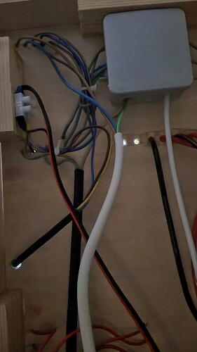

One minor detail that strikes me in the picture:
How many 230V devices are connected to the inverter?
And is there a RCDfor the shore power input or for the inverter?
The inverter’s grounding terminal is not connected.
At the top right, there could be a switch from shore power to inverter. It is not possible to tell from the picture whether the device to the right of it is just a fuse or an RCD.

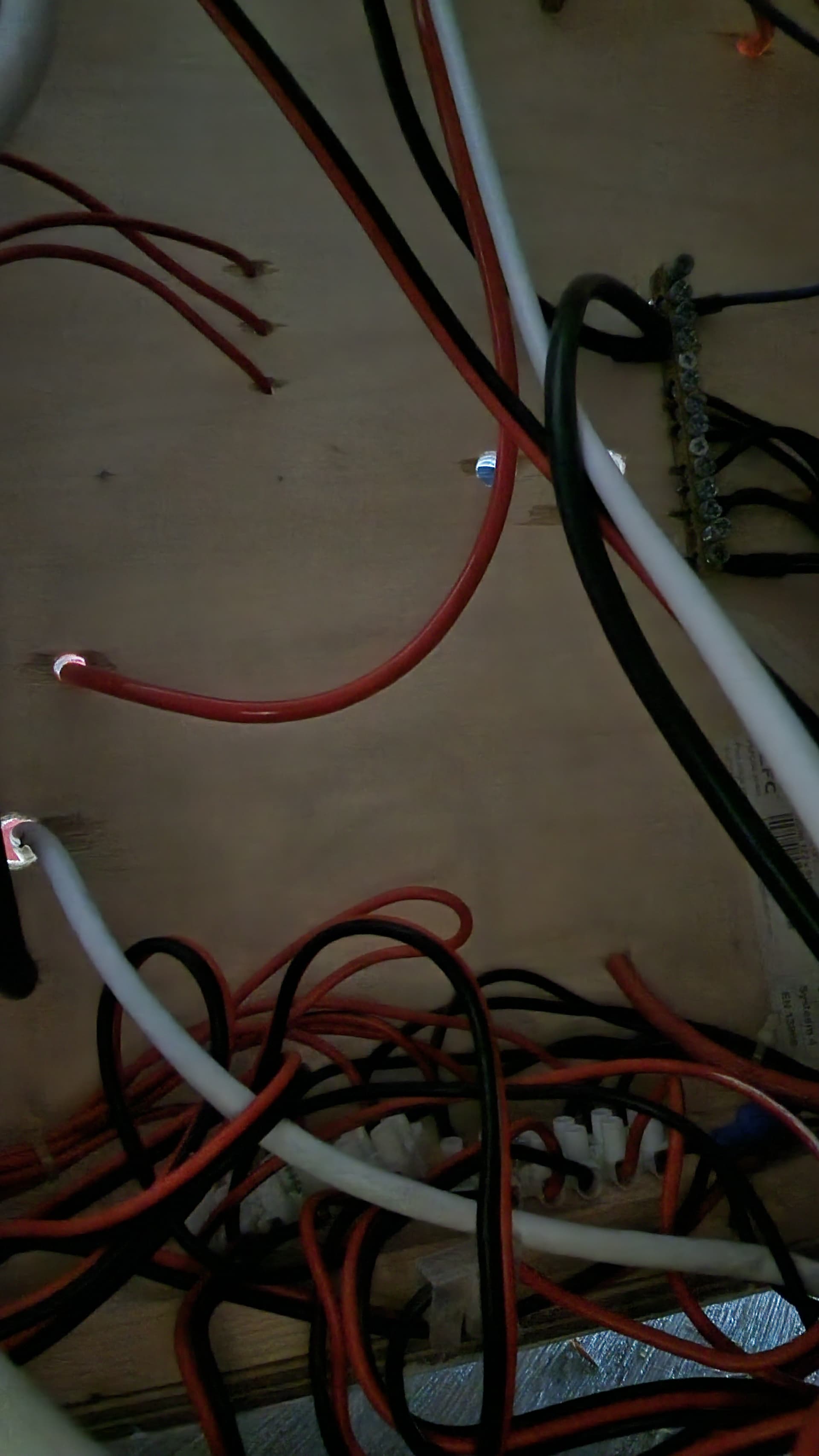

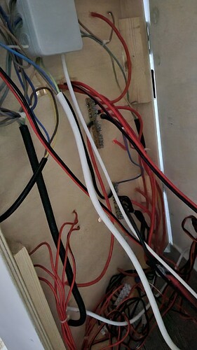

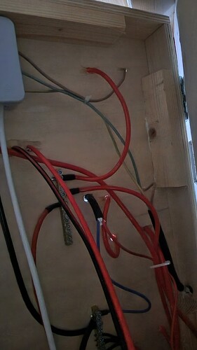

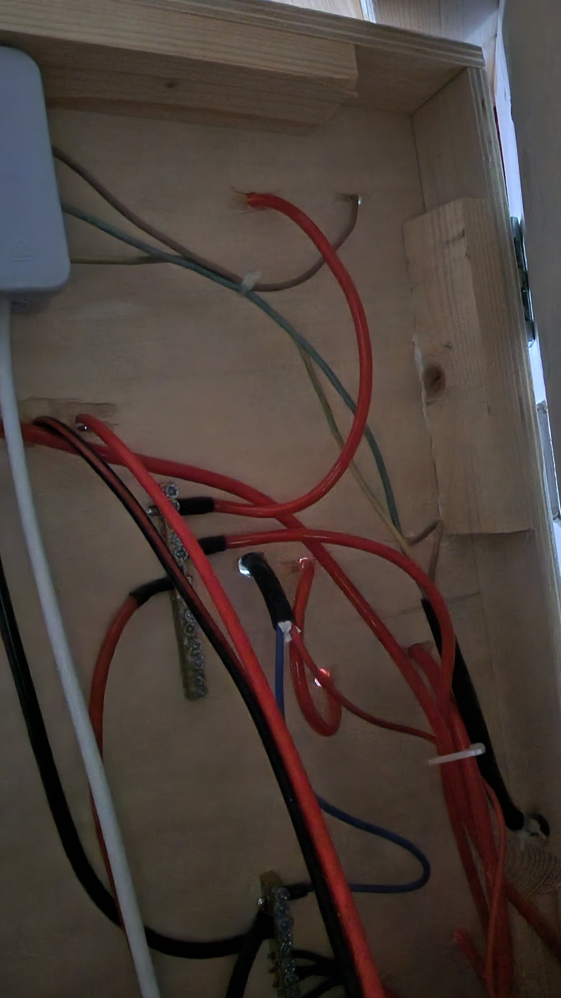

Hi Guys, I managed to have a look behind the scenes, hope it helps to determine the issue.
The fridge has been working fine earlier offgrid, so I don’t think this is a construction problem…
Thanks

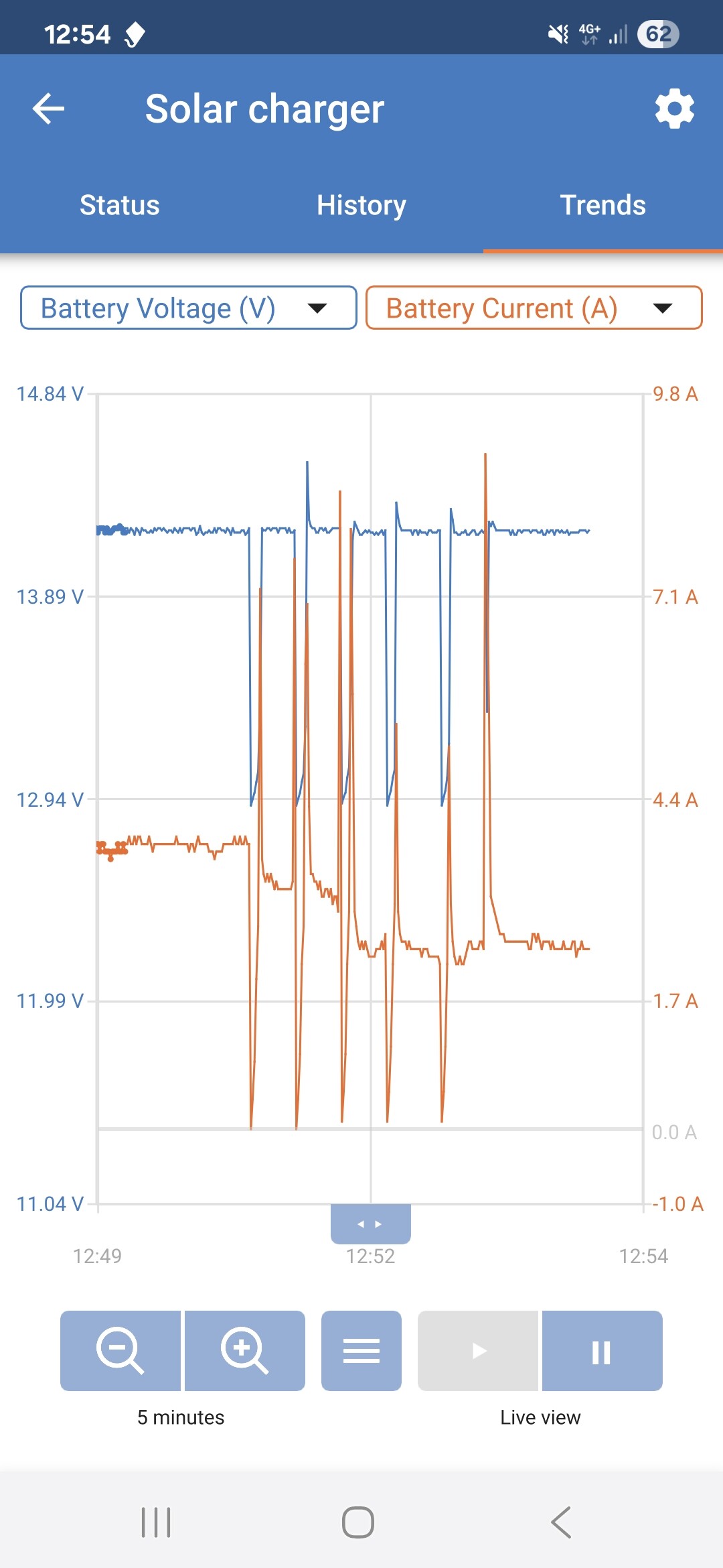

Another shot from the front and from the app. Where can I find / check the dynamic cut off feature?
For now, you need a Bluetooth dongle (see above) or a VE. direct to USB cable and a PC.
Both are plugged into the inverter´s VE.Direct port.
In other words, you CANNOT find the value on the solar charge controller in Victron Connect.

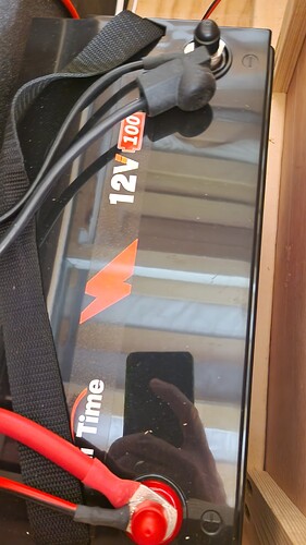

Did you have pics from the battery too?
More later
Here is a photo of the battery
Glad to see a bit of a snake’s wedding behind the orderly front panel.

Hi Guys, I spent a night at a campsite and did some tests. When the camper was connected to 220v, the fridge worked perfectly.
After having charged the battery fully, today I disconnected the van from 220v and started the fridge. It started up from the battery nicely, but after like 20 minutes, it stopped again.
Please find attached some screenshots:
14:20 - disconnected from grid
14.30 - turned the fridge on
14:42 - fridge stopped working
