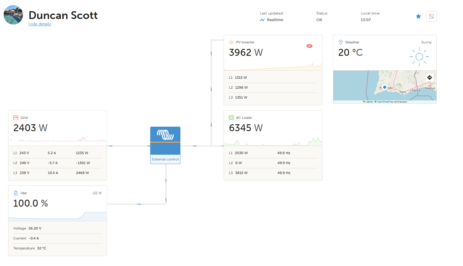

If you are using a single-phase ESS, your Multi Plus is connected to the wrong phase. It is currently feeding back into L2… this cannot function properly as an ESS because it should be connected to L1…
No, as you can see, it is a 3 phase system.. In the above screen shot It is only feeding L2 as demand is only on L1 and L3.

… something I just noticed … the mains voltage of L2 is quite high … It may well be that this is why the multis don’t want to switch on … JUST A SUSPICION … ![]()
