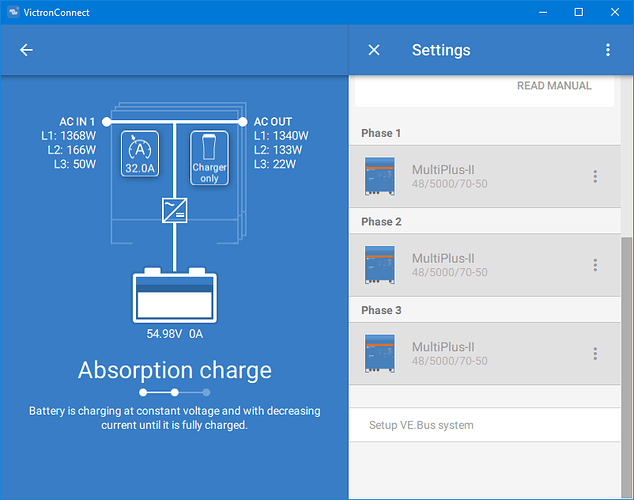

I can see them in Connect. PV is isolated at the moment.
what is happening if you “Setup VE.BUS System” … i have never used Victron Connect for this case …
Nothing, its greyed out.
