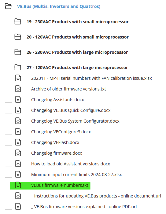

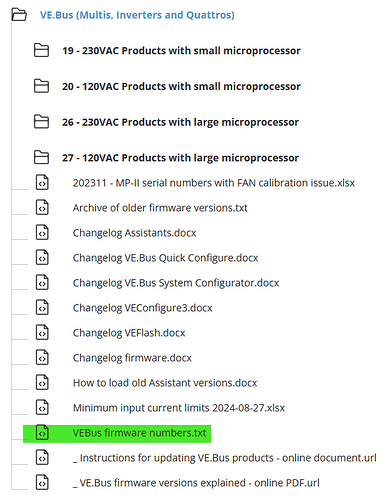

In the VE.Bus section, scroll down and take a look at the text file that lists all firmware prefix and which device they belong to.
Yours should be 2627, v556 is the newest firmware, so 2627556.vff should be correct
  1. To select the right file, check the firmware version which is in the product now. Look for a seven digit number (eg. 2654153) which you’ll find printed on a sticker on the control board. The first four digits indicate the model, and must match the first four digits of the file you intend to upload.
  2. There are different firmware types available. Read our PDF VE.Bus firmware versions explained carefully to select the best firmware for your system. For recent products, use the latest 400 version.
41 is just an example in that PDF.
You have to check what your device is.
With VRM the easiest way is to look in at the device list in VRM.
In Victron Professional in the VE.Bus FW folder is a text file that explains all product IDs.
That’s also described in that PDF.

Models
To get a list of all models, login to https://professional.victronenergy.com, and browse to Firmware → VE.Bus → VE.Bus Firmware Numbers.txt
Thanks! Did not realize that there was such a file!
