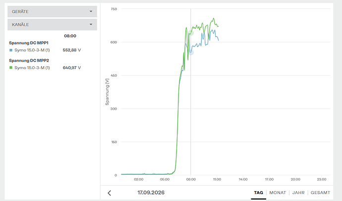

The strings according to Solar.web:

In my opinion, however, it must be something to do with Victron / Cerbo and the integration with the Fronius, since Fronius’s Solar.web displays the data correctly
