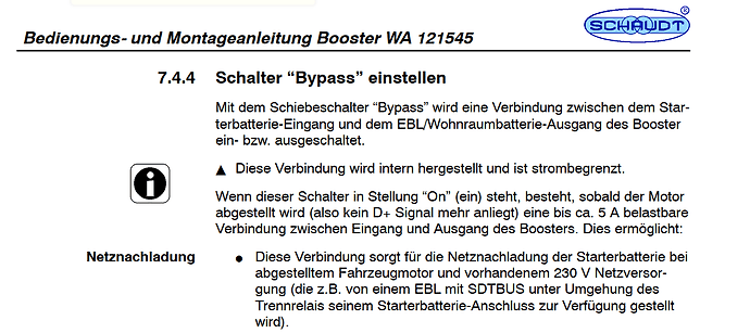

A look at the booster’s manual shows that the leisure battery isn’t charged by the MPPT (7.4.4 Setting the “Bypass” switch)
When 230V power is available (and only then), the starter battery is topped up with a maximum of 5A, but from the 18A charger integrated into the EBL, not from the MPPTs!!!

The booster charges the starter battery from the leisure battery if its voltage is at least about 0.7 V higher. It doesn’t matter whether the leisure battery is being charged by the mains charger or the solar controller. The only important thing is that the charging voltage is high enough.

The Boosters manual states unequivocally that the EBL bypasses the isolating relay via SDTBUS, but only when a 230V supply is present. So much for reading comprehension—incidentally, one of THE main problems Germans have in the PISA tests…

I mistakenly assumed that the bypass worked in a similar way to the auxiliary charging circuit on Votronic boosters. In fact, it only connects the booster’s input and output (with current limiting) for the voltage display and conditional charging of the starter battery on EBLs with SDTBUS. There are only two of those, by the way. All other Schaudt EBLs do not need the bypass functions.
Of course, you could also use the bypass to charge the starter battery without SDTBUS. However, since the current can flow in both directions in this case, it’s better to avoid that, so you don’t end up with a flat starter battery if something goes wrong.
So the bypass should always be disabled without SDTBUS. In that case, the starter battery obviously won’t be charged this way, as you rightly point out. It would be better to use a StandbyCharger instead.
