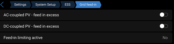

We have installed two Multiplus II-48/3000 with cerbo GX and Smart Solar MPPT 70/150. It turns out that on ESS the Grid Feed-In is disabled but still the system is sending to grid. What adjustments need to do to lower the value even though the system does not have an energy meter installed?

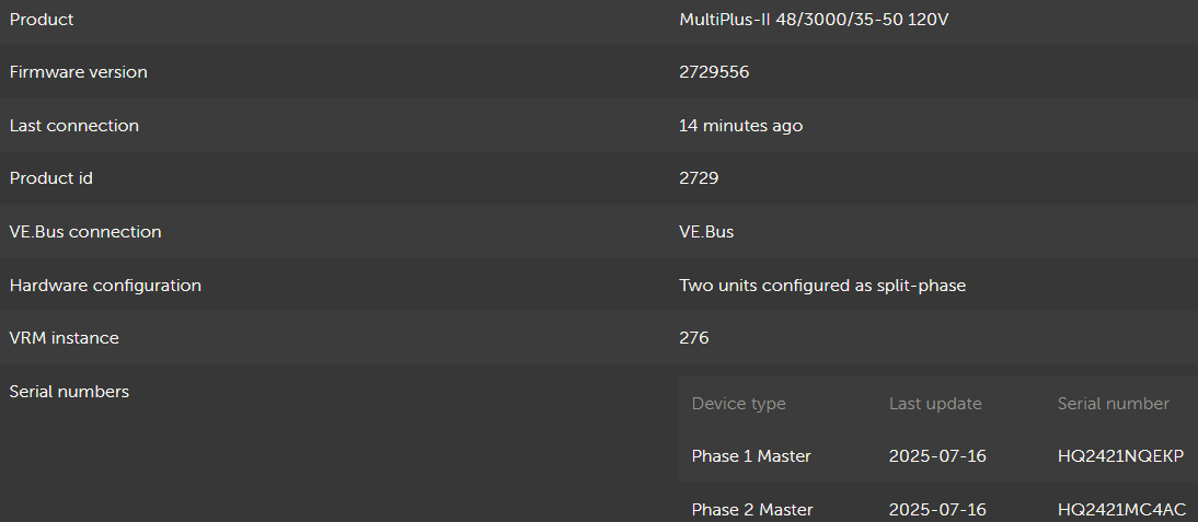

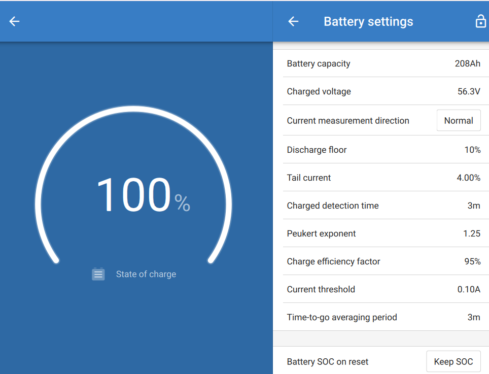

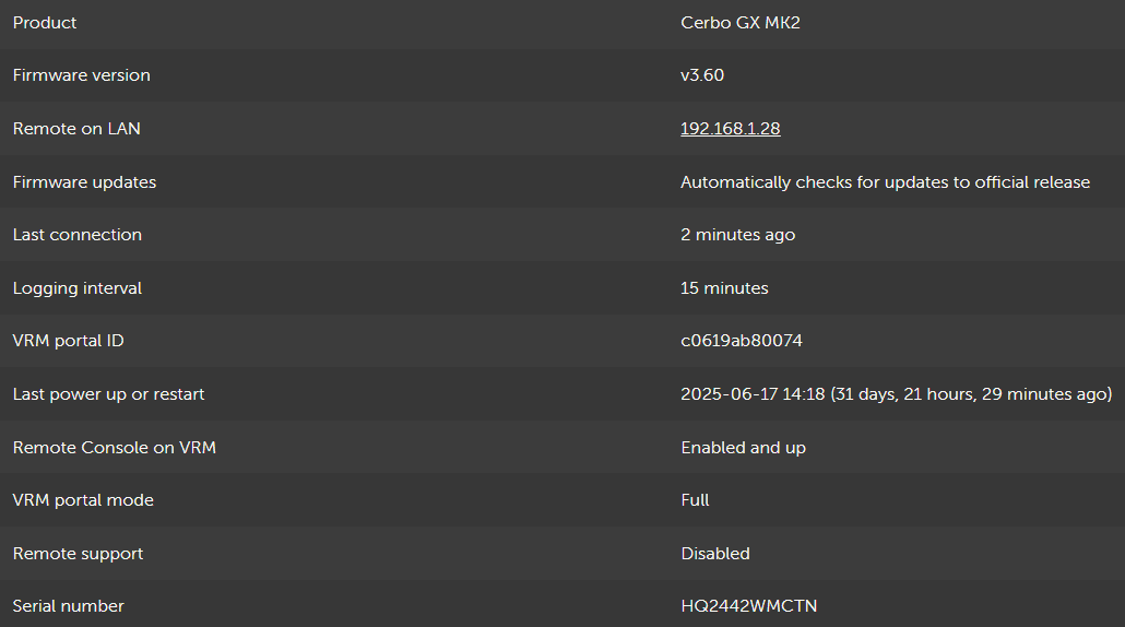

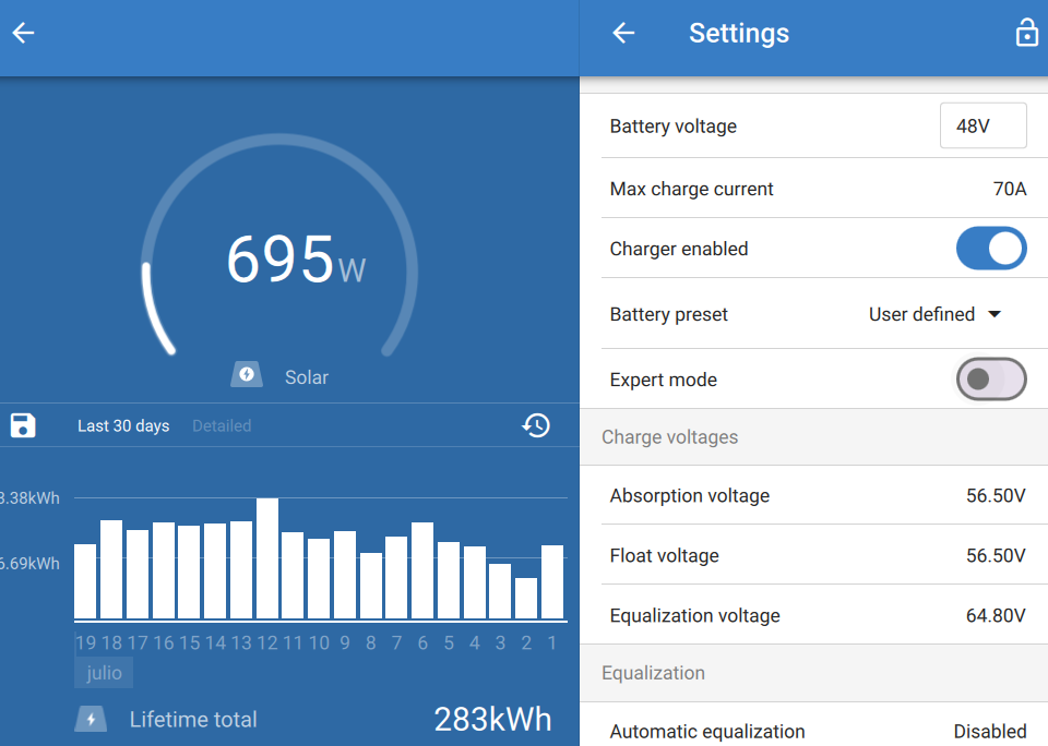

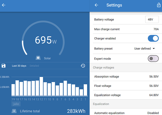

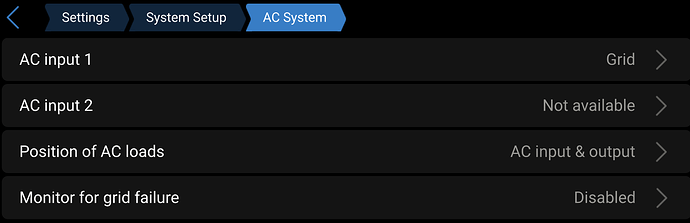

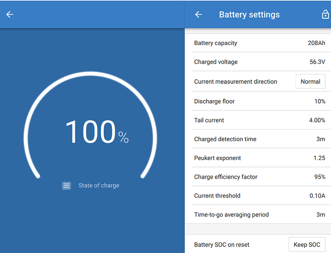

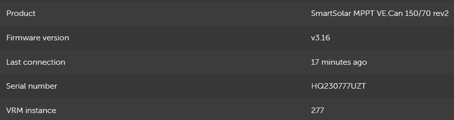

Hello @nickdb I’m glad you replied. Here you are components and configuration:
Let me know if you need further info.
Regards.

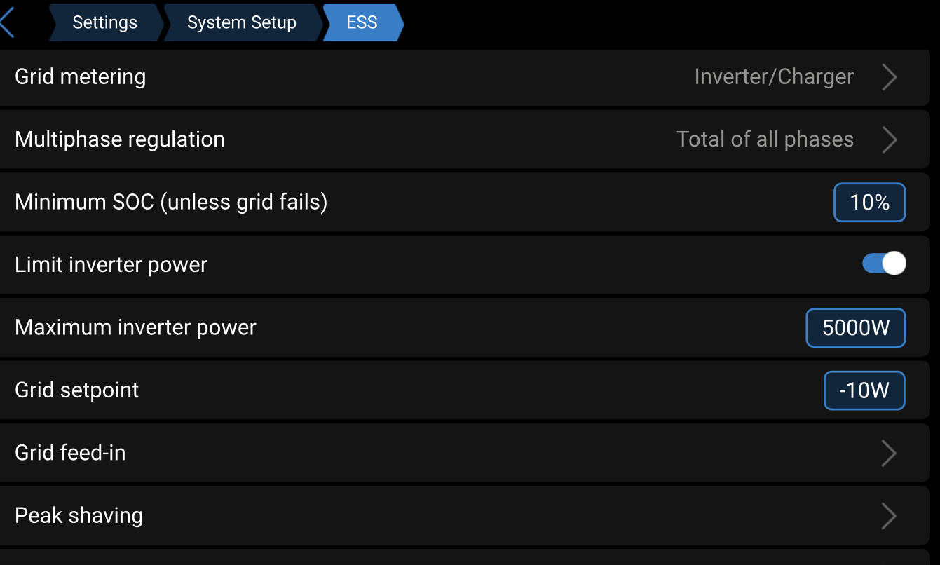

I would start by changing the grid setpoint to a positive value like 30 or 50 for example.
Yes you need a positive number as a grid set point. With the current -10, ESS is always trying to feed at least 10 watts back to the grid.

Do you really have loads before your inverters (in ac system)?
You have plit phase I do not have any experience with that type of set up, i do have on 2/3 phases etc.

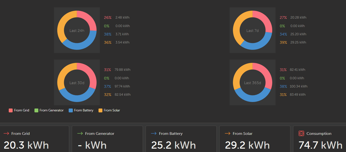

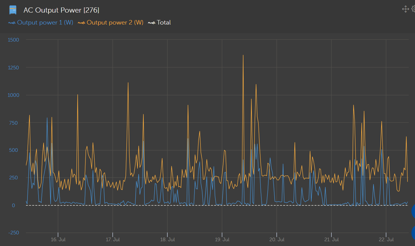

If there is an imbalance between systems this can help you identify it:
The entire building is powered for inverters output. Both phases are not balanced:
Phase 2 is significantly more loaded than Phase 1. Is this an issue causing feed-in although is not enabled?

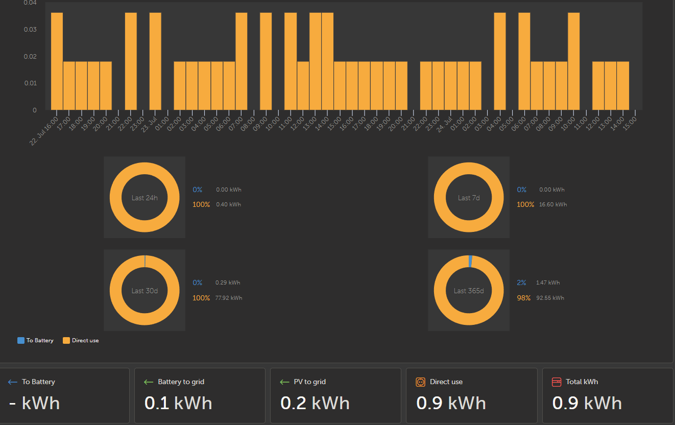

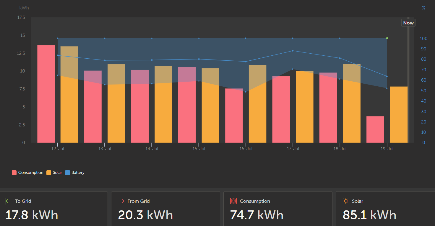

The system is grid connected but the meter (not bidirectional) is measuring these values fed -in as consumption and although solar and batteries are saving the electricity bill will be affected by this value.
Try switching to individual phase regulation.
And then ac loads are on the output only.

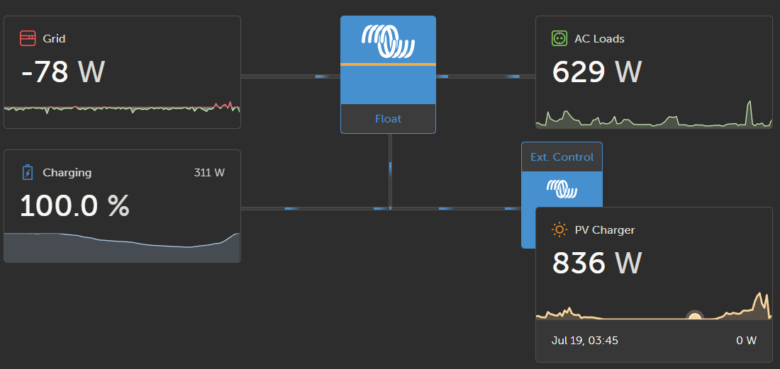

@lxonline that did work along with balancing the loads for both phases:
This is the picture where feed-in is very low.
