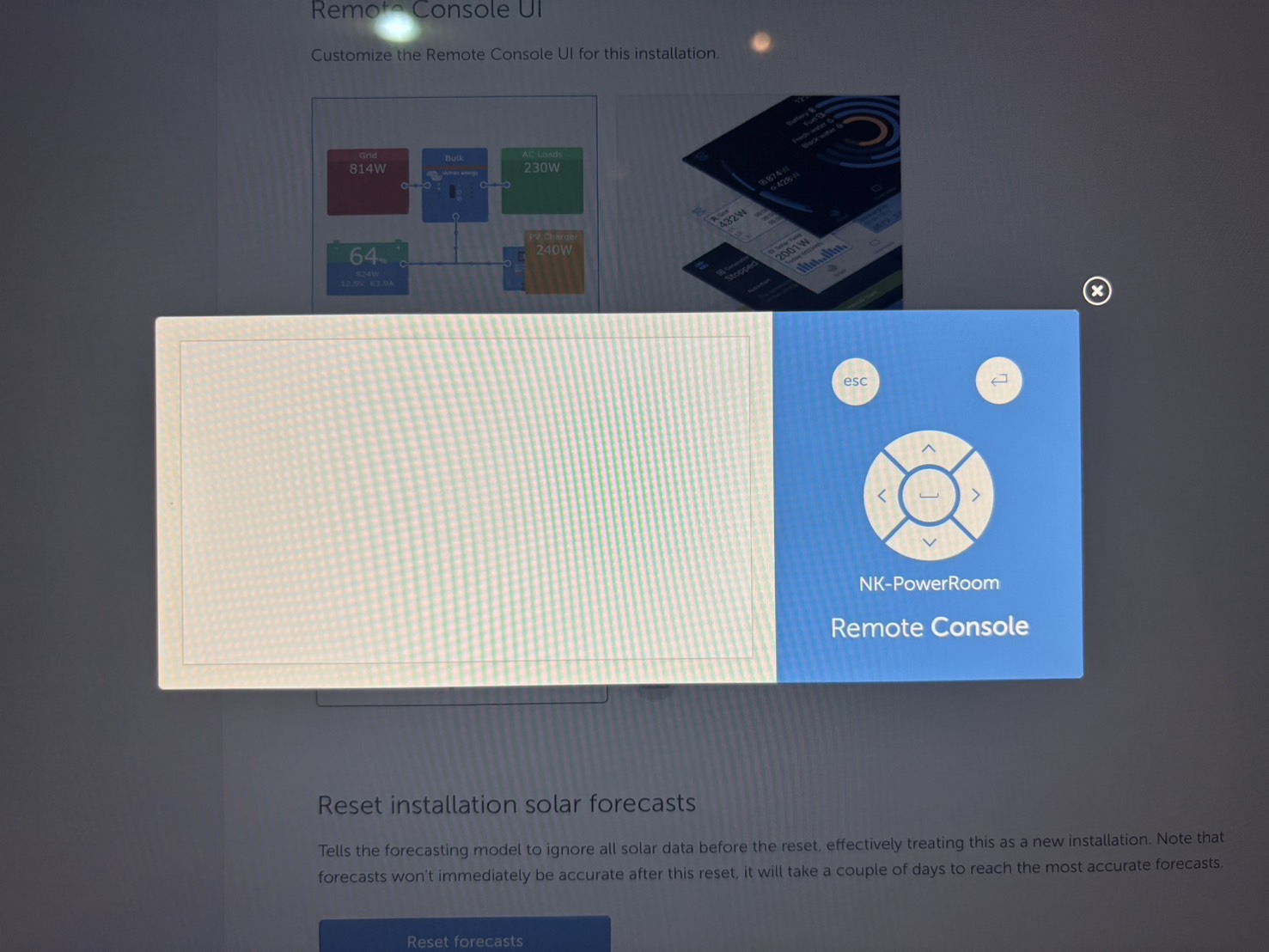

10 out of 10 times, seeing a white screen after updating Venus OS is due to third party modifications being installed, like GuiMods, Tailscale GX or others, and them being out of date. And because of being out of date, they are not compatible with the installed version of Venus OS.
This is not Victron’s fault or something that Victron can easily prevent. And not perse the fault of the modifications either. Its just something that requires extra attention by the user when having third party modifications, mods for short, installed .
Its visible as a white screen on the real display, like on a Color Control GX, and on GX Touch and Ekrano GX. And you’ll also see it when opening the Classic Remote Console on VRM.
Note that only the Classic UI is affected, not the New UI. To lean what Classic UI and New UI are, read here.
To solve this, those mods need to be either updated or disabled/removed.

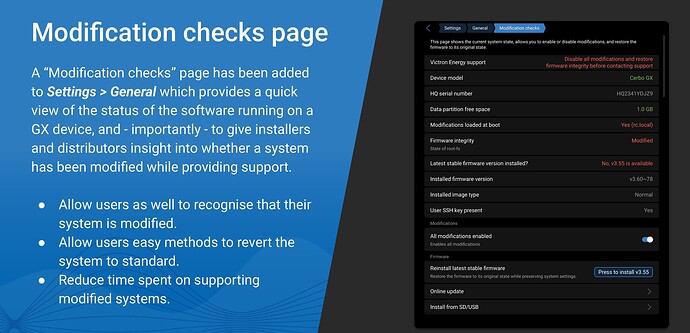

Open the New UI in a web browser, and check the new Settings - General → Modification checks page:
Step by step:
Access the New UI
On VRM, click Remote Console and then choose the New UI.
Local to the system, on a phone, tablet or computer on the same LAN or WiFi network, try either of these links:
Goto Settings → General → Modification checks
You’ll see a page that looks like in above slide.

First disable the “All modifications enabled” setting using the slider on the page.
Next, click the button that allows to reinstall the update.
Note that this also disables Node-RED and SignalK. There is currently no option to only disable the installed third party mods.
