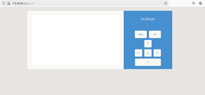

The graphic doesn’t show any values and block-pictures. Even the the hotkeys, settings and branches arn’t shown anymore. It doesn’t matter, if I connect via lokal network or direkt near via the MP’s own WLAN Access Point.

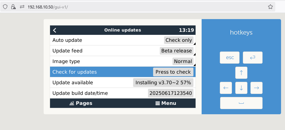

When I now upgrade to v3.70-2 (newest offered by gui_v1)
the gui v1 is empty again:
So I switched again back to v3.54 for time being and may continue the next days with trouble shooting to find out how to fix this straingh issue.

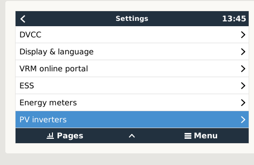

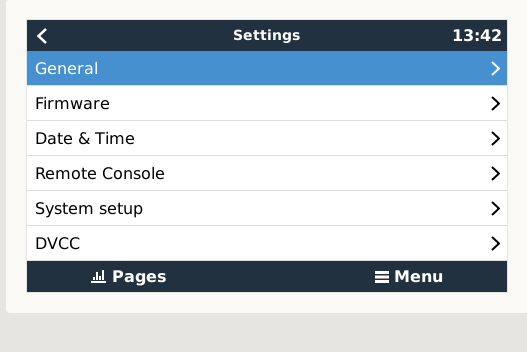

Did you installed some packages such as guimods?
to check this you could scroll down in the settings menu
If the menu option package manager exists then you have :slight_smile:
hmmm … not that I know :thinking:
I went to the settings under gui v1, from beginning till the end
nothing to see like “package manager” if I understood you right.

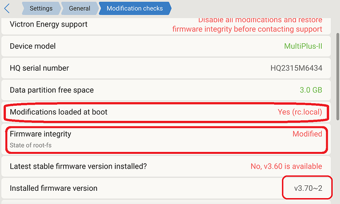

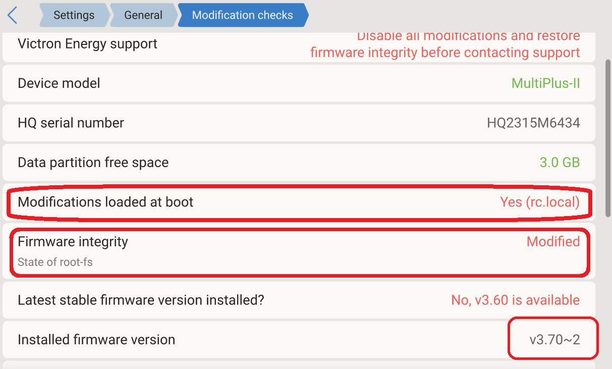

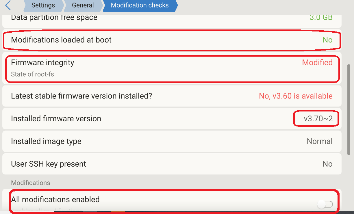

If you open gui v2 on 3.60 and go to general modifications it will confirm if any mods are loaded.
The majority of issues are a result of mods loaded on the GX.
Hi Nick,
thank you very much for the hint !
I checked for modifications :
=> modifications in rc.local
Then I disabled the modification and rebooted.
but the gui_v1 keeps still empty.

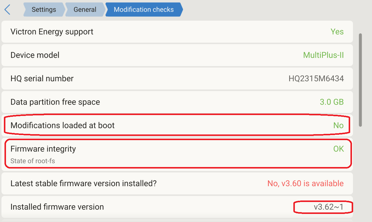

Then I’ve done an FW update to v3.62~1 (provided online by gui_v2)
Afer that gui_v1 is working properly
many thanxs :folded_hands:
