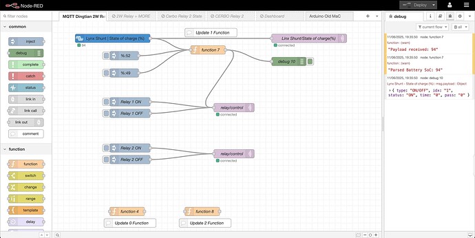

Where is Node-Red gone in Venus 3.60?
I have installed the Large version earlier but I have not checked yet however I would expect Venus updates to automatically chose the correct version based on the one running at the time of the update.
I fear that, by replacing Venus , it might have wiped out any additional software installed so I would have lost Node Red including all its additional components like extra nodes etc.

I appreciate the amount of work involved in creating such a new update and I can confirm that it did not wipe out my Node Red flows.

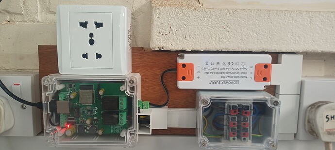

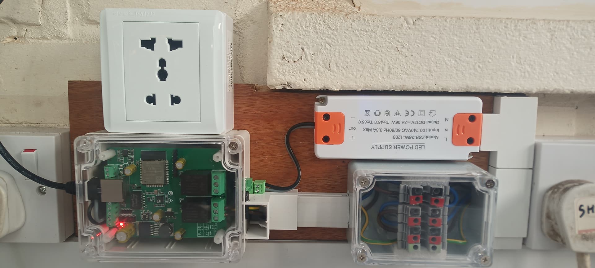

The only external added device at the moment is a Digitaian Relay that controls a water heater via Node Red according to the battery SOC

Here she is when it was first commissioned 14 months ago:

It seem to have cleared the mods message but it does not have Node-Red running so I suspect that it needs the “all modifications enabled” turned to ON.
Can you confirm this please?
That should be on yes. By default it would be off.
You can then check that MQTT and Nodered, in the integrations menu, are still enabled.
