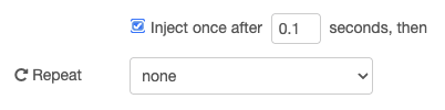

Just a hunch, but does increasing the delay of that initial inject to 0.5 or 1 second help?

For my particular flow: unfortunately, no.
(I added 1 second extra delay to the original value)

  • Significantly increase that default “Inject once after” to 5 seconds or so. That should reduce the amount of problems.
