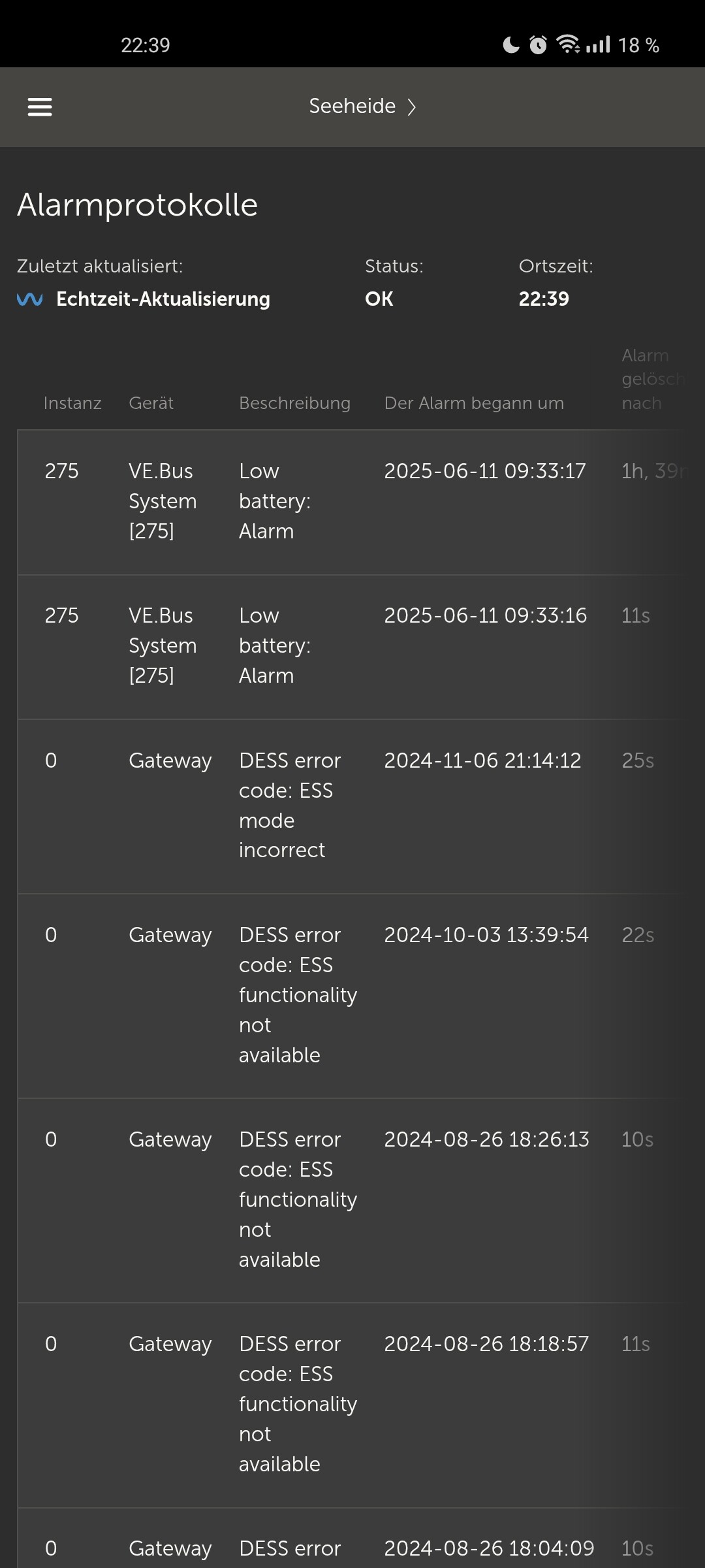

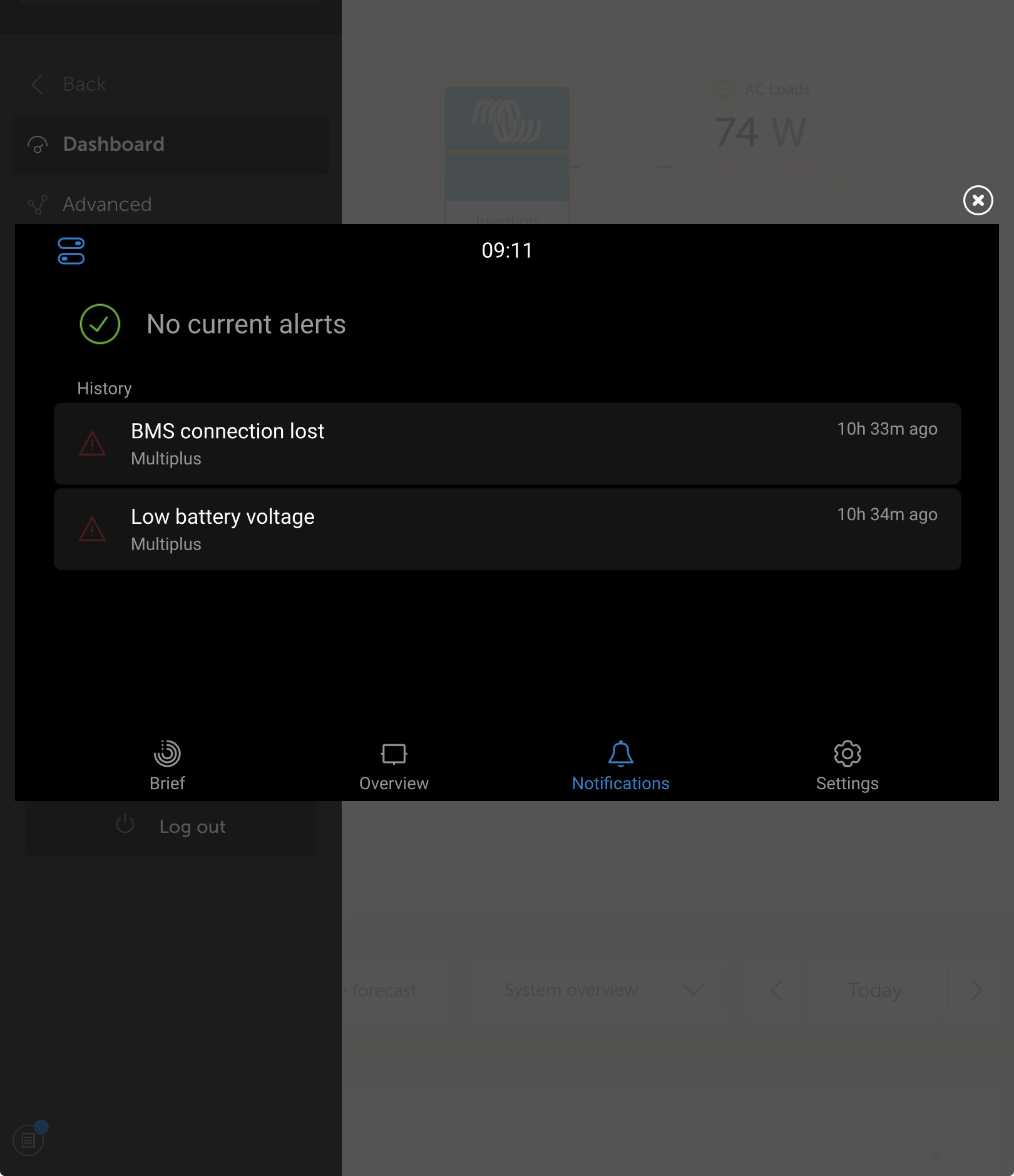

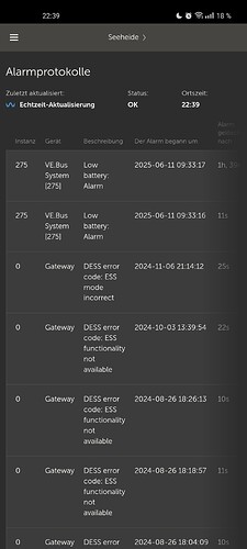

We are using Victron Multiplus 2 5000 GX and had the exact same issue today at 09:33 in the morning. All values in vrm stuck and Multiplus gave the Alarm message Low voltage and BMS disconnected. The batteries had 40 % capacity at this time. It seems that the issue begun in the night between 00:00 and 01:00. Because there are No values. I restarted the Multiplus and after that everything was working.
We were on 3.55 Firmware and I thoughtbit could be a bug and did a Firmware Update to 3.60. Automatic Update is disabled because after every Firmware Update i lost my custom configs of grid, shelly and PV inverters.
Anyone with the sme Problem ? Its Strange that there are other Users with the Same Alarm Message today.
I checked the setting for Automatic Update. The value was on “Check” not on disabled. Maybe a big Firmware File was downloaded and the File system of the nanopi was Out of space ?

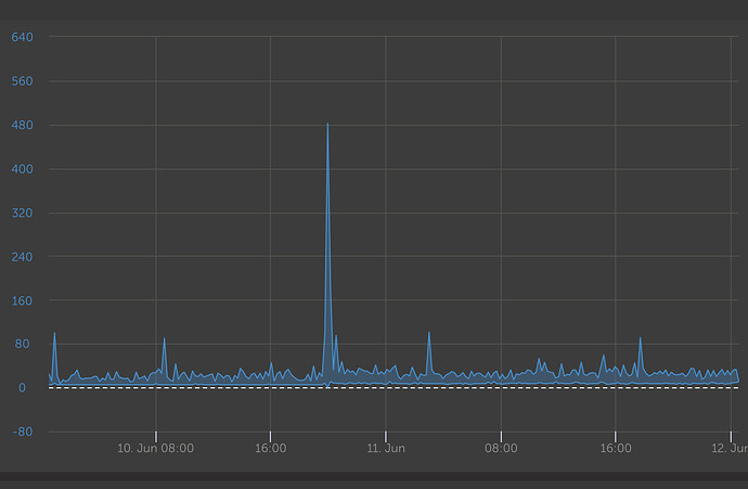

My late 2017 CCGX running ESS with one BlueNova battery and MPPT connected via ethernet briefly lost BMS connectivity during the update, which saw it work hard as per attached. Was restored soon after and stable since.

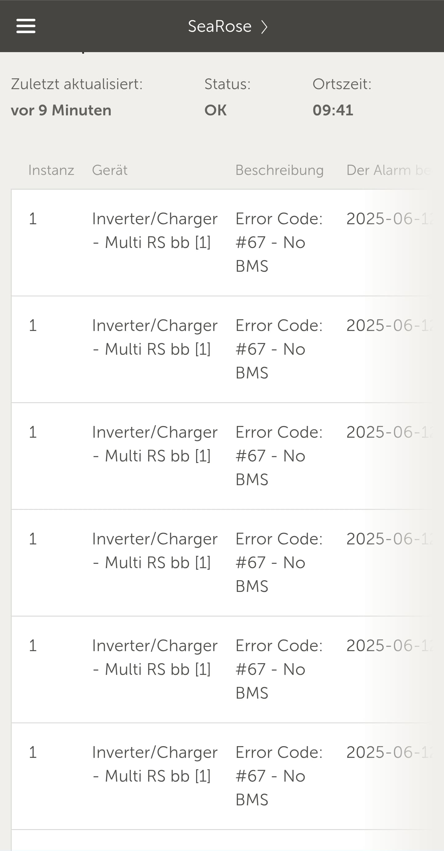

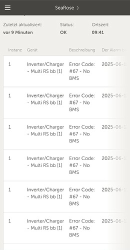

yes, here also problems with version 3.60, off-grid system with BYD BMS, got about every 3-4 hours an #67 error, connection with BMS lost and 2x a power shutdown, reverted back to version 3.55 and all normal again
