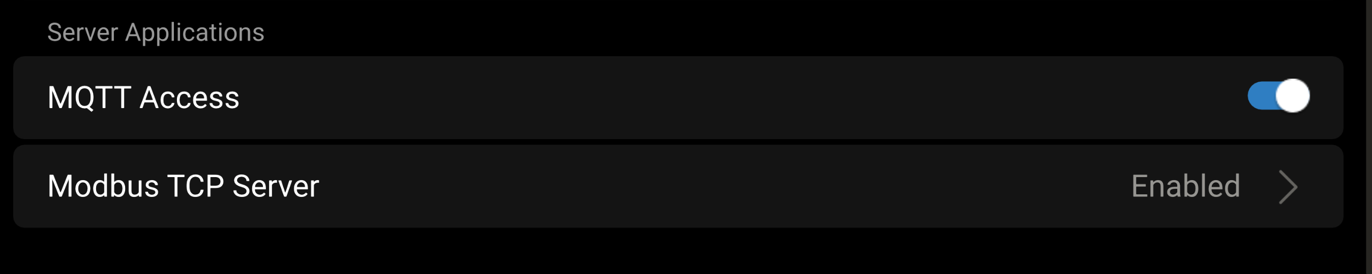

Where is Node-Red gone in Venus 3.60?
Venus 3.60 installed.
Node-Red no longer visible.

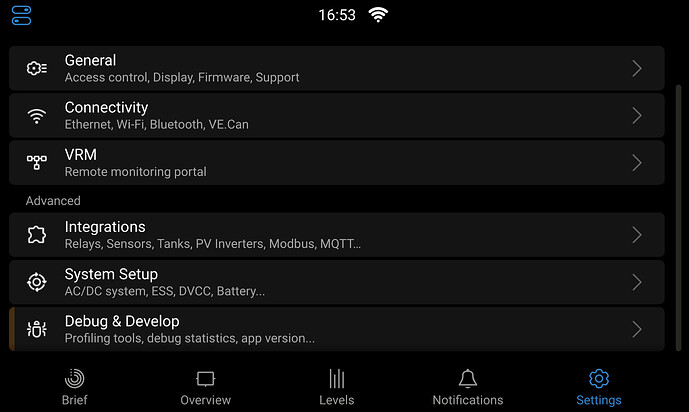

Cannot find Node-Red in the Settings Menu.

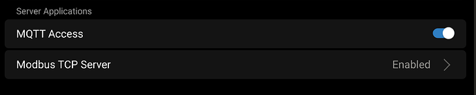

Modbus is still active and visible.
Anyone knows where it has been moved to please?

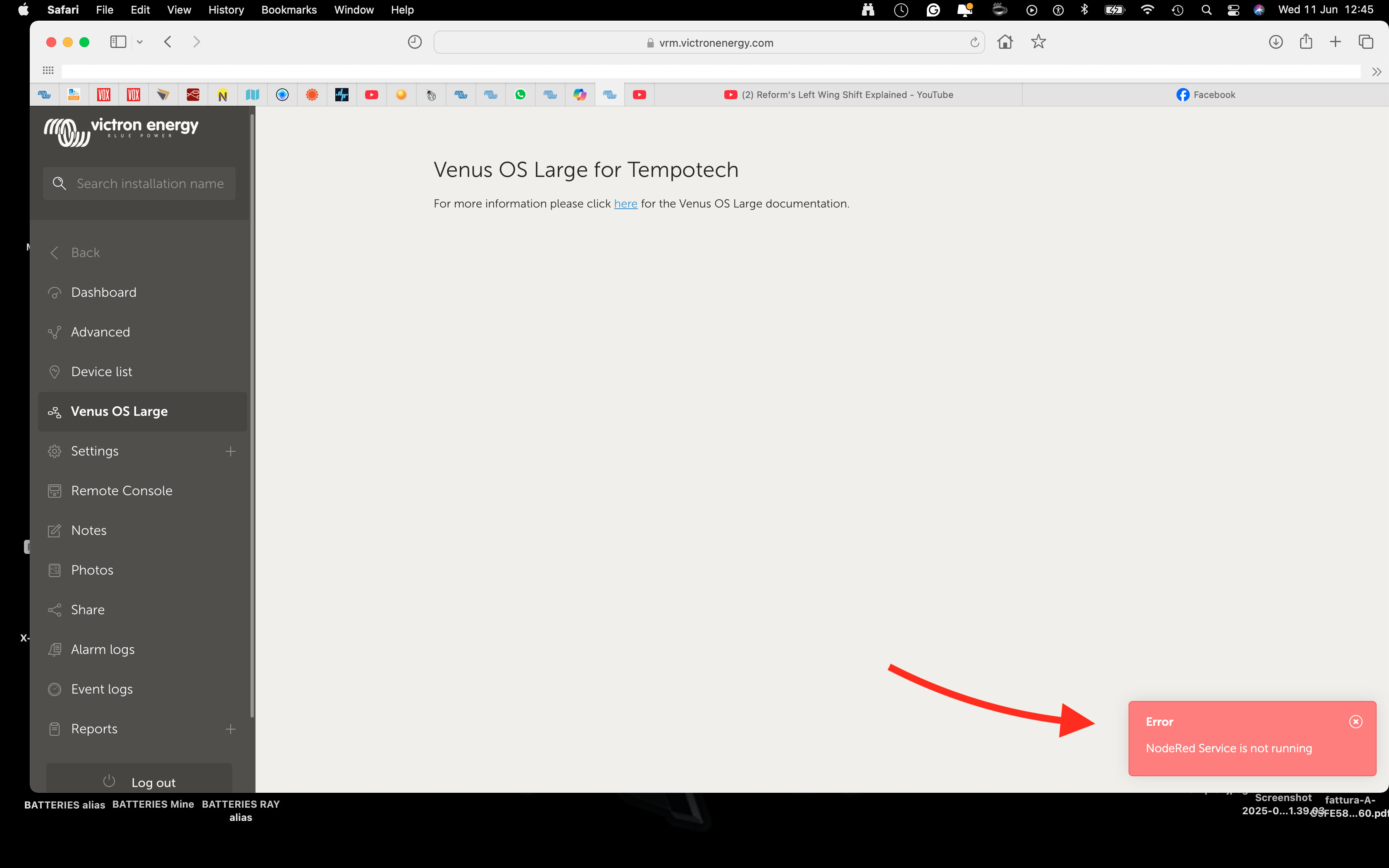

After a while the message “Node Red service not running” disappeared but still no sign of it.

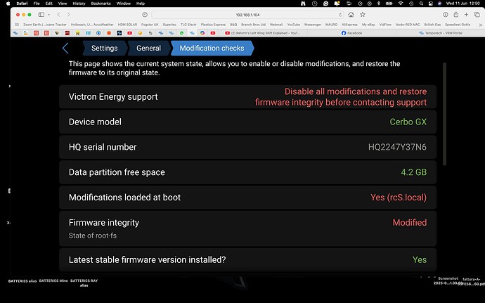

That is just a check for support to confirm if OS mods are loaded. Often support is logged and this isn’t mentioned, so it helps with troubleshooting.
I just have the large image loaded so it isn’t flagged.
There were some big changes and mods can break things, so check git and be sure that the mods you have are up to date.

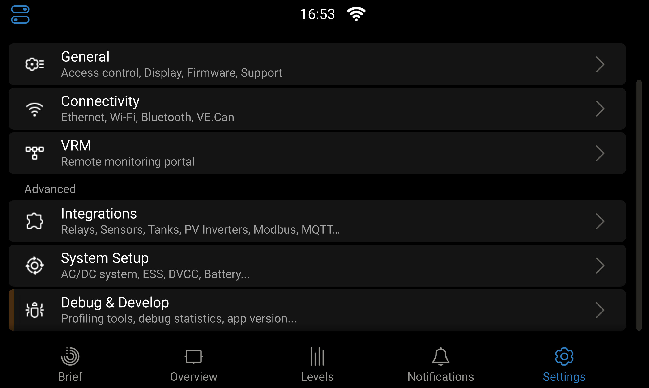

  2. The settings manue has totally been rearranged so, as per my original questio, whew should I find the Node-Red “ON/OFF” swithc now please?

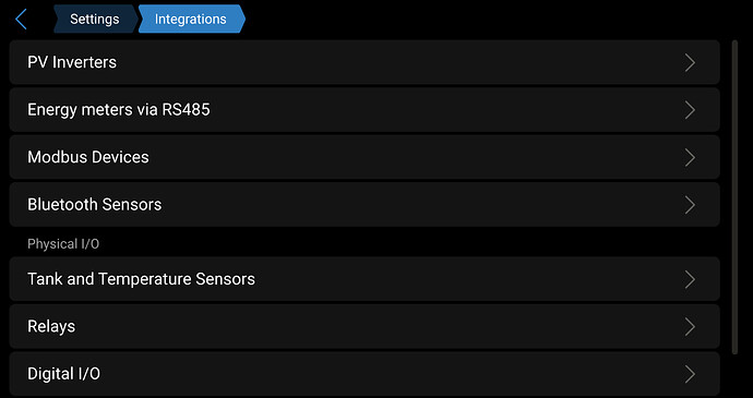

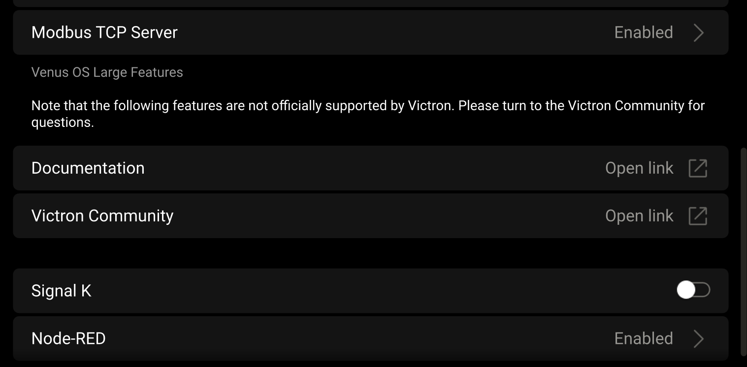

Under integrations.
Mods aren’t done via the gui, it is done via ssh.
You can reset the device in the same modifications menu, preserving other settings.

That is where I was looking for but it does not appear to be there
Never before! There was a simple Node-Red “on/Off” in the menu

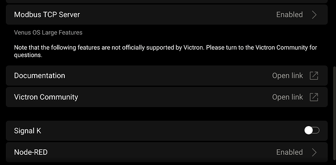

I know this is a dumb question, but you did upgrade to the large image because if you are on standard image then there will be no Node-RED.
It’s not a dumb question because I’m not sure there was a choice between Large or Standard image, I simply followed the latest update.
Nobody, so far, has enlighten me about what could have happened after the update.
I can see that I can change to Large now, but I’m not sure that my Node-Red settings will be restored
What hardware device is this?
The device is flagged as modified, so something is off.
I can not say why you lost large image but if you download large image you may recover your Node-RED, I have gone large - standard - large before.
You could always try and revert to previous firmware first and see if you recover then export your Node-RED and redo v3.60. I always export a copy of Node-RED flows after any changes.
