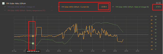

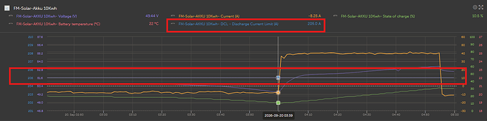

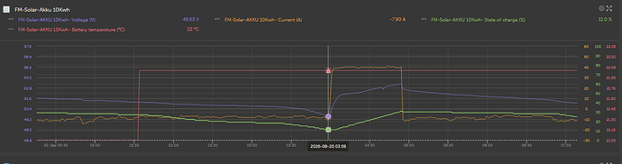

Here is the charging display for my battery while it was still discharging:

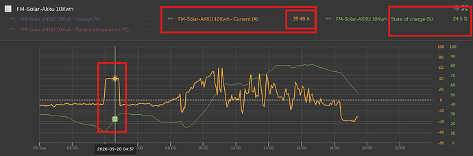

And suddenly it started charging… at 4 a.m.!!!

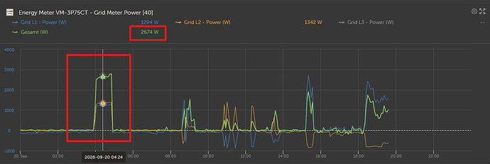

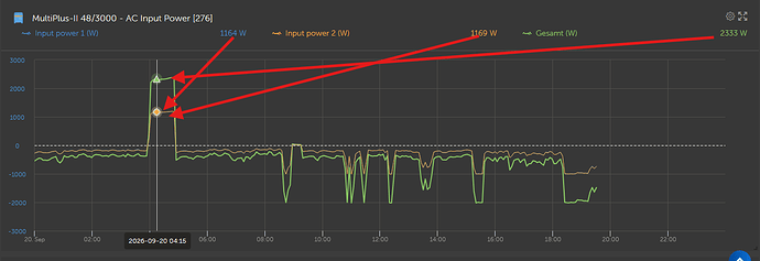

Here you can clearly see that the MultiPluses were showing positive values, meaning that the total grid import was over 2300 W.
Here is the extract from the Energy Meter:

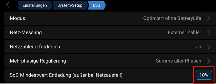

Here are my ESS settings:

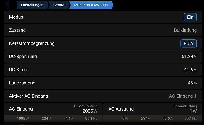

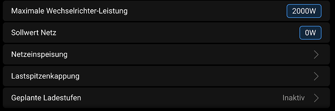

Here are the settings for my MP-II:

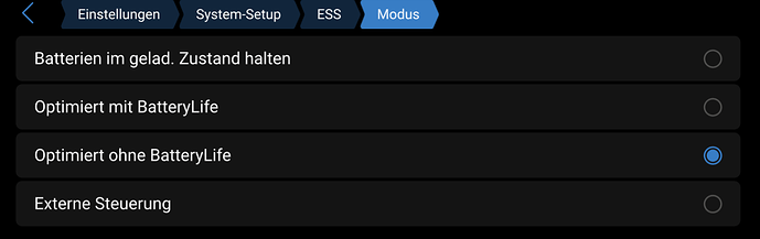

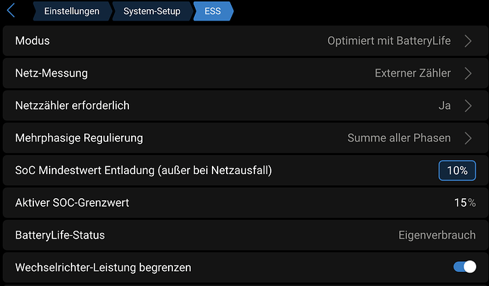

First, switch the ESS mode to “Without Battery Life” and observe the system again to see whether it discharges down to the configured 10% SOC. The other possibility is a system-adjusted “Battery Life” setting, which could well be causing your minimum SOC to be overridden in the background. That would be the 15% …

I’ve now set it to the following:

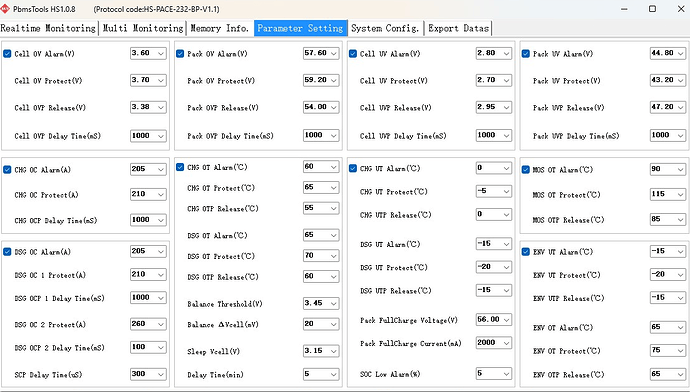

Furthermore, there are batteries that only allow discharge down to 15% and then trigger an alarm. In that case, the BMS would need to be set to 7% (anything below 10% will do) for this to work with your limits. However, you haven’t written anything about the battery/BMS.

Look at the signals the BMS sent during that time.
When DCL is set to 0, the system switches to charging and charges up to the sustain voltage.
“Have a look at what signals the BMS sent during that time.”

Here’s the battery data
And the ESS settings:

Here is the battery data
The graph shows that the voltage has fallen BELOW the Sustain voltage!!!

The DCL is constantly at 205 A
If I increase the value from 10% to 15%, I’ll generally achieve less sustain voltage, won’t I?
If you increase it from 10% to 15%, you’ll use more electricity from the grid because your minimum SoC is higher, meaning you draw less energy from the battery. However, your battery probably won’t be charged up to the sustain voltage.

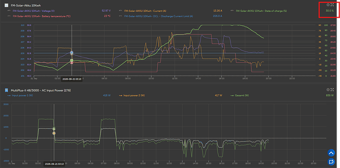

Yes, exactly. Your values aren’t wrong for a 16S battery. If you look at your graph above and see how quickly your battery voltage drops from around 3:40 onwards at the same current, I’d say a minimum SoC of 10% is too low.
Okay, I’ve now set the value to 15%. (I can’t access the page via the web at the moment. I did this on my smartphone.)

Because you can clearly see that the battery is ALWAYS charged up to 30%, including last night
It’s also noticeable that the total charging power is always around 2,300 W, i.e. around 1,150 W per MP-II.

You can of course set the charging power under “Charger” … or (indirectly) as an input current limit … but then it applies to the entire AC input

That just leaves me wondering where you can set the charging power and the charge cut-off (in %). IN THE MULTIPLUS AND CERBO SETTINGS
