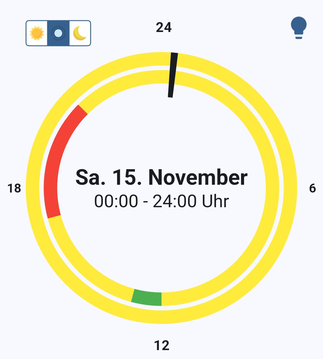

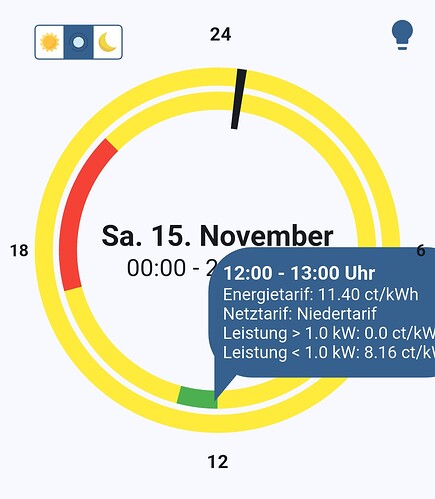

This is currently in the testing phase in Austria, NetzOĂ–. Whether or not it will be implemented is still uncertain. At present, the test program always includes a low-tariff zone and a high-tariff zone. The start and end times for both will only be announced at 4:00 p.m. on the previous day. Whether this will actually happen is uncertain. However, a test group (including myself) is already participating.
But it gets worse: within both the low-rate and high-rate zones, performance-based network charges exist, at least for the time being in the test program:
As I said, this is currently a test program. The extent to which it will actually be implemented is not yet certain. But I think we should all prepare ourselves for something like this.

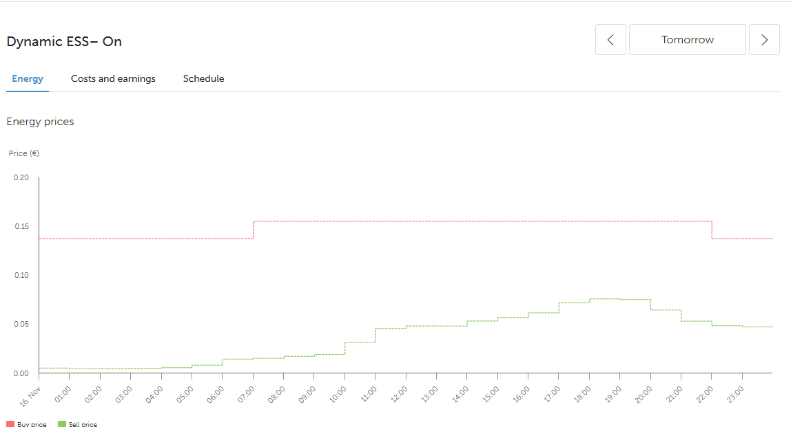

Hi Barbara. About defining selling price formulas for specific times of the day: In the Netherlands the energy provider Zonneplan adds 10% bonus to what they pay you for delivering solar (or battery) power to the grid during daylight hours. Would it be possible to set “sunrise time” and “sunset time” as start/end of a price formula period, instead of specific times?
It looks a bit odd, but there are many Zonneplan customers. I could approach it with setting an average correct time period for the season or so. But you like to serve the peak demand hours of the day as best as possible. And they are normally around sunrise/sunset.

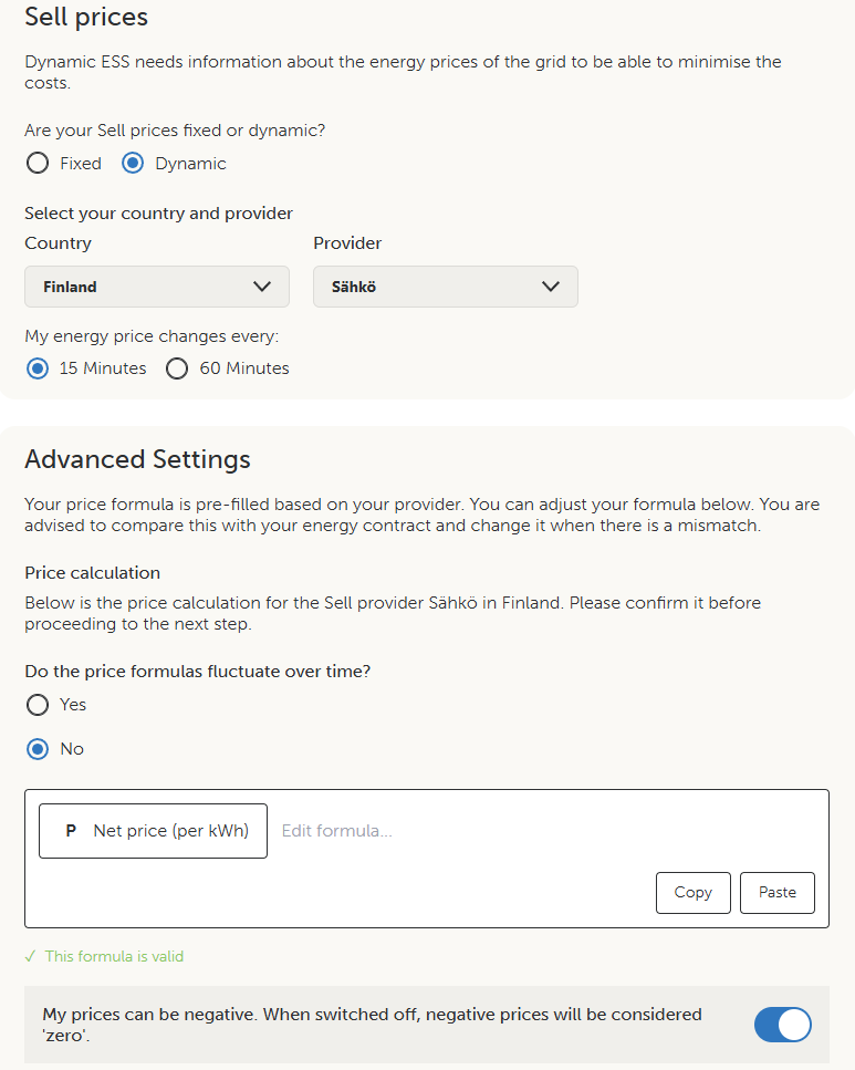

I am having some DESS 15 minute pricing issues. It shows 1h data, but I have 15min interval configured. Maybe it’s related to the new VRM DESS changes? Thanks.
Hi, I am still having this issue with sales pricing. I have 15 minutes selected but VRM plans with 1 hour. Could someone from Victron take a look? I remember this being ok when 15 minute pricing got launched, and now it’s broken. Maybe something in the latest release affected it.
